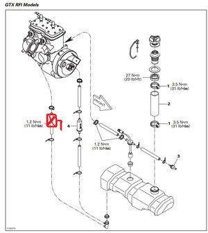

These are 3/8" ID valves. I like these because they are easy to move from "off" to "on" and it can be done with one hand. Otherwise I would need to get 2 hands in there, one to hold the valve and hose in position and the other to turn the valve. I'm not exactly sure of the part number.
So that would be the line in the middle with the filter on it going into the front of the engine correct?
The line without the filter going to the rotary valve. The LARGE line coming of the bottom of the oil tank.
