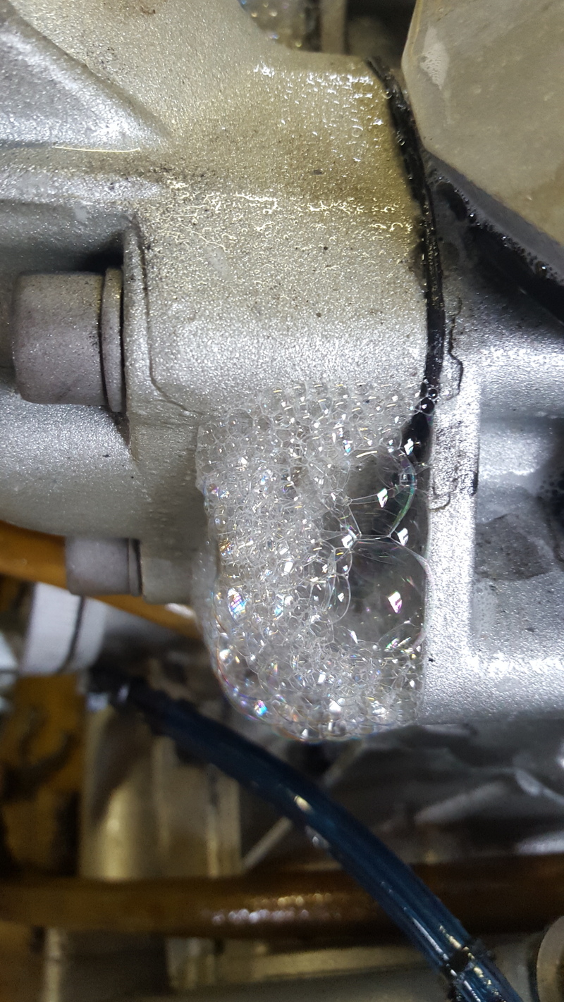

Man are these great. Just used them again today. Thanks Dan. Sure helps to know when there is an air leak
