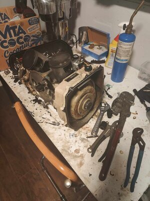

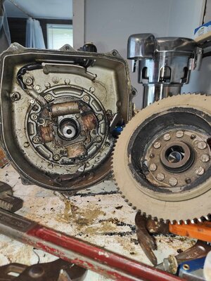

ANYWAYS. I was riding my 96 GTI in the ocean the other day and and boom. I stopped the engine to drink some water and the starter was not turning over anymore. Pretty damn scary. I ended up swimming it to shore. I took the engine out the same day and everything looked good. I was so afraid I exploded a piston or something. BUT I smelled and also heard crunching in the flywheel area. I remember the guy I bought it off said he replaced it? Not sure.
Anyways, bought a new stator(magneto?) and flywheel. Just curious as to a cause of this to happen? Excessive shaft play? Just chance? It doesn't look like the stator melted or anything.

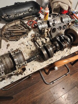

I installed the new stator and flywheel; I noticed the crankshaft had a lot of vertical play. I split the case and noticed that the two front bearings pretty much fell apart. So it was probably crank play that exploded this.
