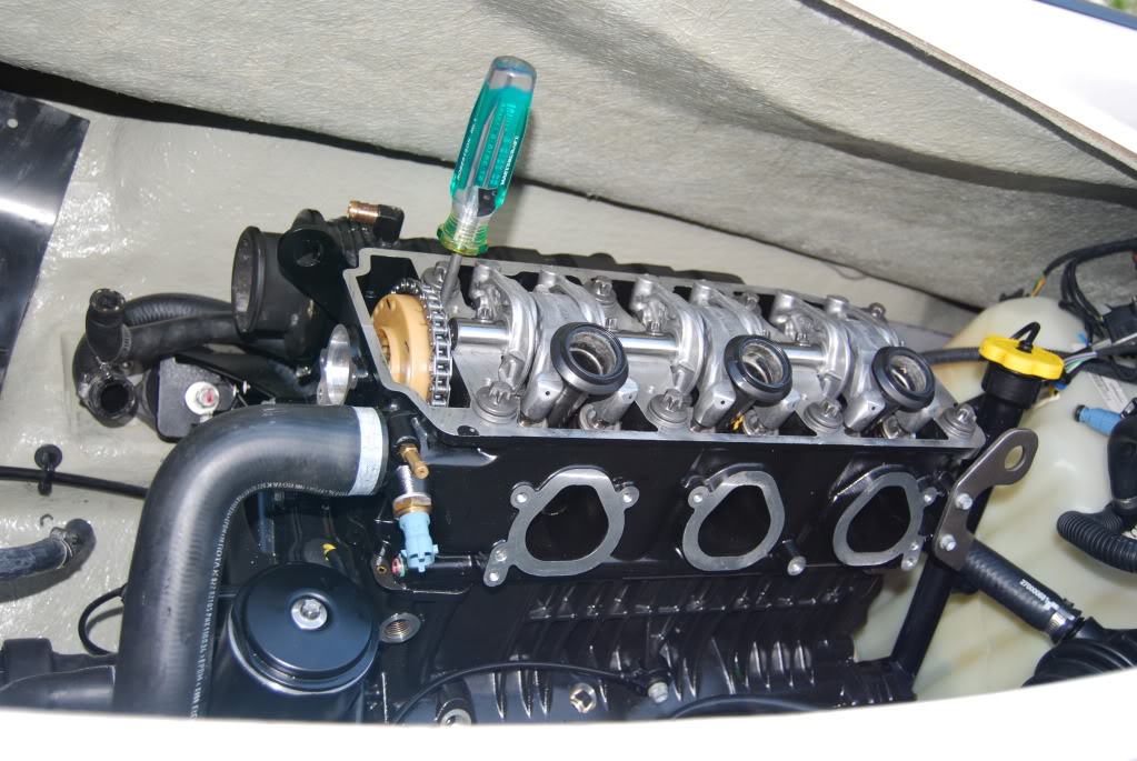

Looks great so far, did you clean the block or was it this "shiny" already?

The ski was at the shop they installed the timing chain but didn't think to check the head. Obviously it showed up on compression test, so they went back to kelton and said it was going to be more dough. Thats when he peaked out and wanted to sell the ski (he's actually not a bad guy really... He runs his own law office so that's where all the funky vocab was coming from. Anyways ... cost me $320.00 for 6 exhaust valves, $100.00 for 2 exhaust rocker arms and about 36 hours of my time (labour, travel, research). I borrowed my bosses pontiac vibe (it's got a hitch) to head to ohio my avy is brutal on gas. Bout $130.00 in fuel and another $150.00 in lodging and food. I also bought an 11' trailer to go with it for $950.00.

The block was in great condition minus six bent exhaust valves and two cracked exhaust rocker arms. I did clean up the head and pistons (why not it was off right).
I didn't take any pics other than the ones above. Anyways, she's running mint ... hooked on the back of the truck I've got one more phone call to make and I'm bailing outta the office early!!
