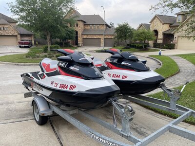

Picked up 2 - 2012 Seadoo Wake Pro 215
One has 37hrs other has 38hrs
Both skis ran when we looked at them; upon messing with the display (going through settings with engine off) one of the skis would no longer power up. We assumed battery voltage and proceeded with purchase.
Recharged battery when we got home (didn’t check voltage before hand) current voltage after charge is 12.74v.
Still have no power to the gauge cluster, no beeps, only a small relay clicking in the back. Swapped the relay with the ski that’s working and same issue was present.
Confirmed we have 12v to the cluster (at back of pins) and all fuses in fuse block are good.
Any suggestions on where to look as we have good voltage, the relay is good, and good fuses?
