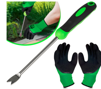

As noted previously it is not hard to disconnect the strap but is very hard to reinstall it. See the link below.
The reinstall it I had to remove the large hose coming out of the water box (not easy to pull off) to provide access so I could connect the end of the strap closest to the drive shaft as the final connection. Soak the water box with Windex under the strap so it will stretch easily when you reinstall it.
To remove it I used a long handle weed removal tool to push down on the metal ring on the end of the strap furthest from the drive shaft to unhook it from the bracket on the hull.

I bought the tool you mentioned above. Still can't get the damn strap loose. So I opted for pulling the SC out several inches to see the engine would turn over more than a 1/4 of a turn. The engine wouldn't turn over more than a quarter of a turn counter-clockwise. The SC blade spins freely though.
