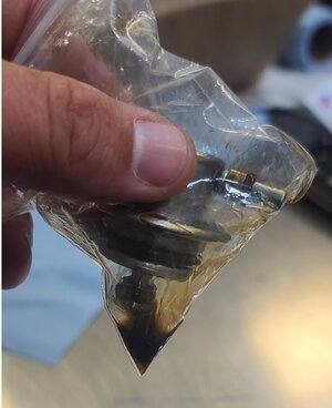

I agree....the problem is my original pump is now dead to me....because that pipe cracked and its leaking inside of the pump.... it looks like the pump may still be good....but the intake filter was just so clogged it was caked up.....and then the rail was nasty and i believe now after seeing my orings that they all were leaking in the fuel rail. because they shrank so much and water and/or rust was in there so the fuel was dark brown dripping out of the fuel regulator...
The fuel regulator is in the bag and the air regulator is the one with crap all on the bottom... they both had brown crap all inside them and coming out of them...
