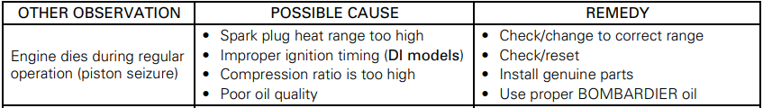

I attached a screen shot from the troubleshooting section of the service manual.
