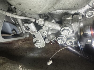

Dogger Member Today at 2:22 AM #27 Don't worrie about the beep as long as it turns over and I'd open the gas screw more till it starts smoking then turn back in..book calls for 1 1/2 turns out im at 2 1/4 turns out. High speed needle 3min out
