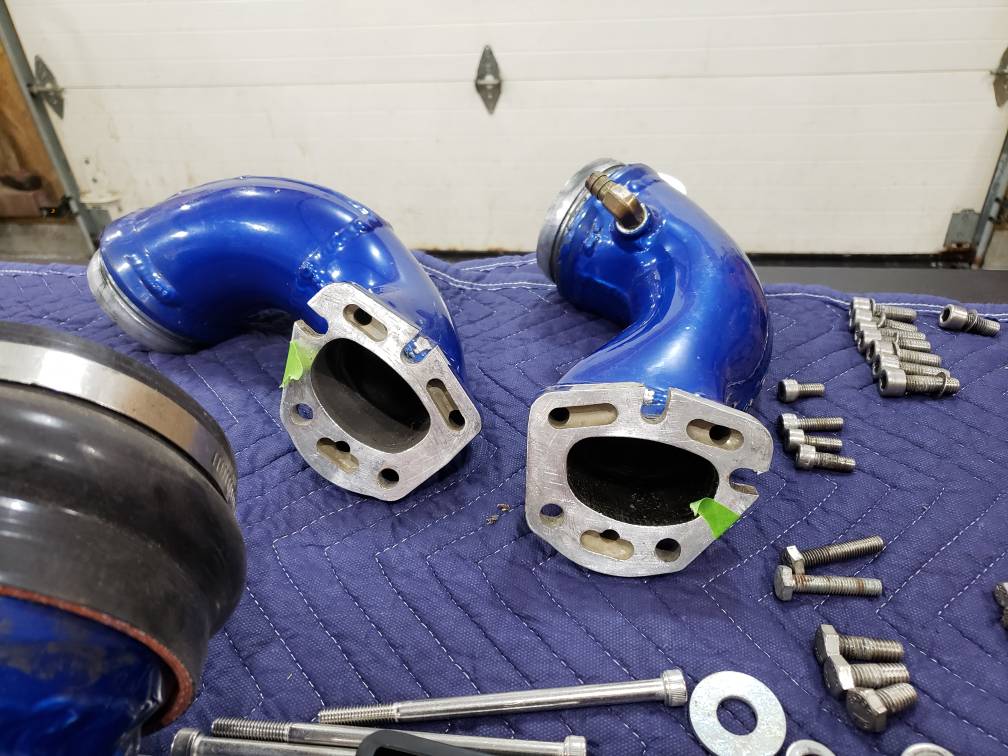

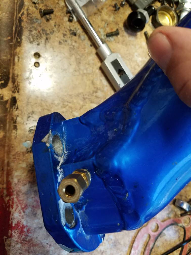

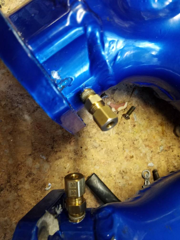

Where did you install your egts? Do you have a pic?
There is one spot on each header you will miss the water Jacket
In the pic I put green tape on where I think I should put the egt. I know I'm not drilling on the bottom but on the side...just easy to take the pic like this....thoughts 1 of 500

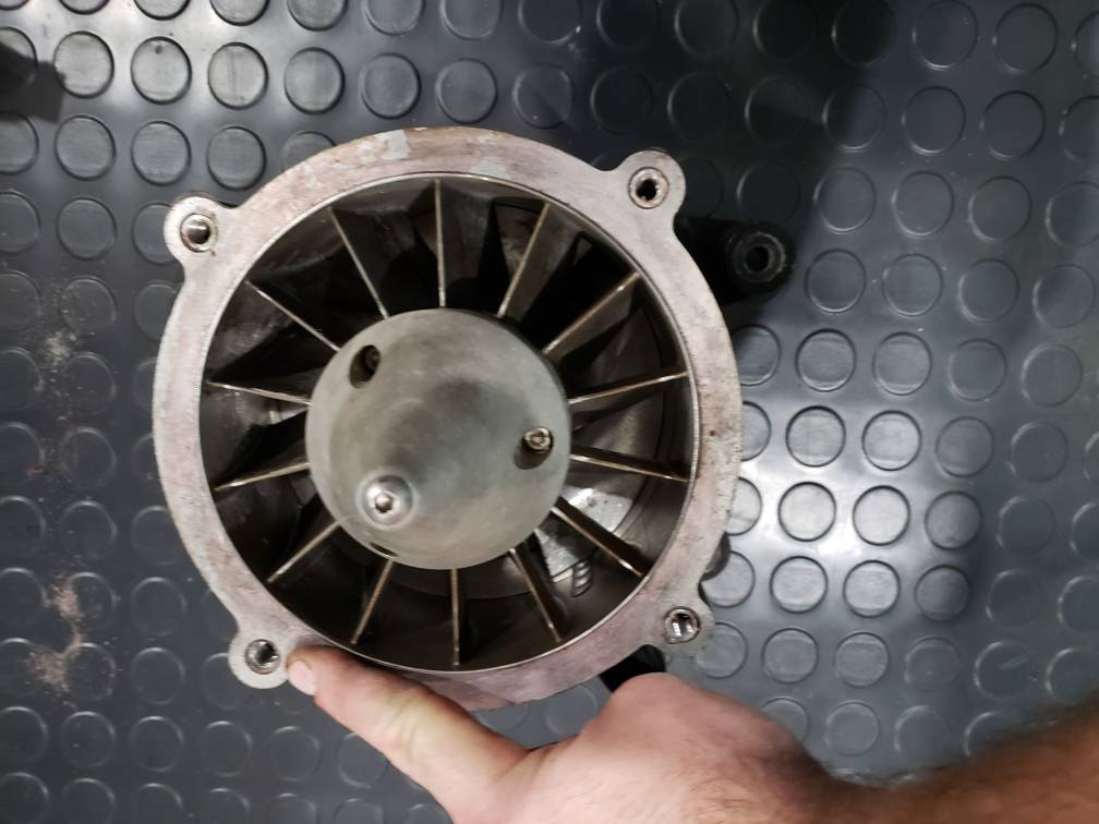

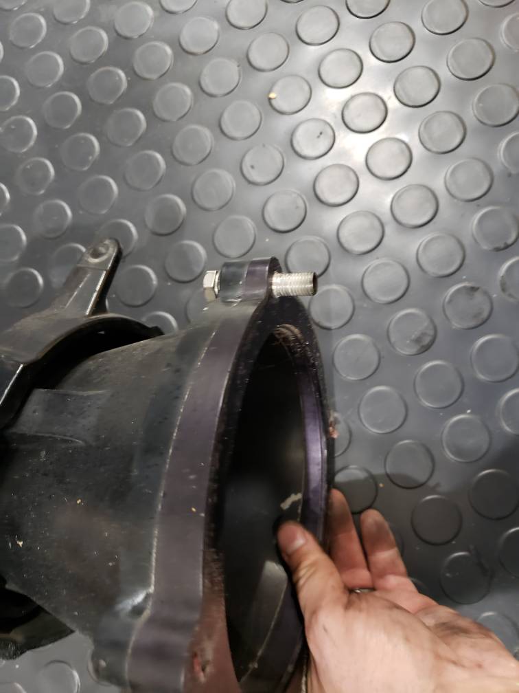

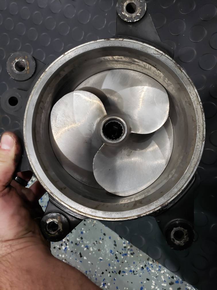

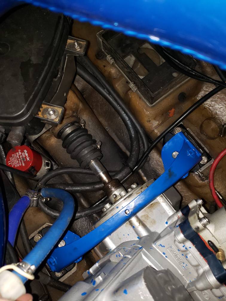

Well I put the motor in the ski tonight. I will work on alignment tomorrow. I pulled the pump off tonight. Thoughts? One of the bolts that holds the nozzle on ended up pulling the Helicoil out the scat pump. Have you guys ever seen this?
They sell repair Helicoils that are for fixing stripped ones like that, they are a little bigger. You could also call Glen at Skat-Trak.

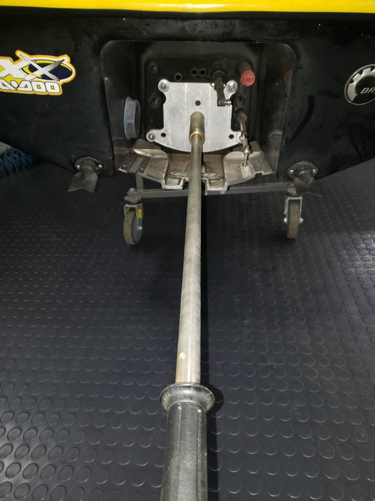

Ok got the right Helicoil tonight. Its an M8 by 1.25. Pulled apart the scat pump everything looks to be good. Just going to do an oil change. Is it okay to run this type of oil just like in any other Seadoo pump? I also got the motor aligned, just need to tighten down the bolts. I picked up a Brand new Ultrasonic Cleaner ,so the carbs will go in that tomorrow. I really look to finish the ski up this weekend as far motor work goes. I about forgot, I just got me a new cover as well.
