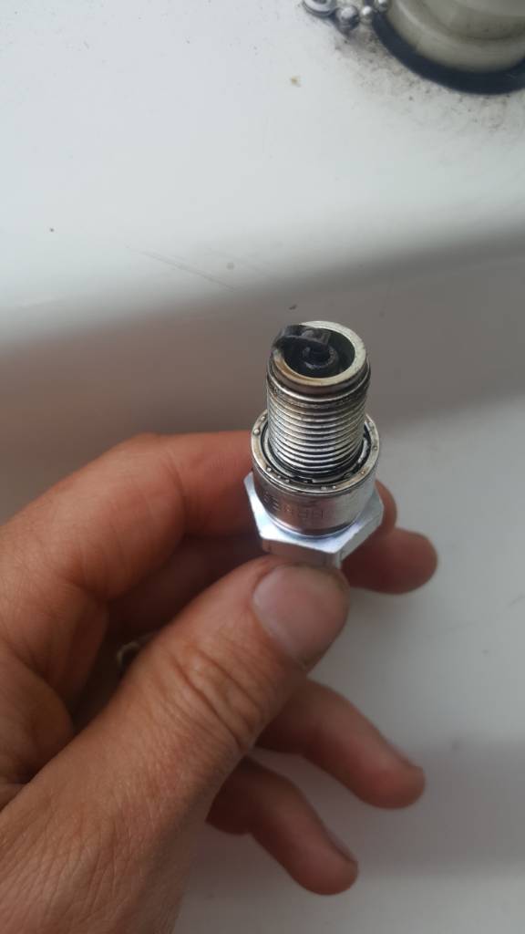

These are the spark plugs after about 1.5hr run time. First 2 are from new motor. Does the color look about right? 1 thing that concerns me a bit is that it looks like a little bit of water on the second one. There was a little bit of water on the spark plug holes so I'm hoping it was just from that. I used all new gaskets on the cylinder head and torqued bots correctly.
