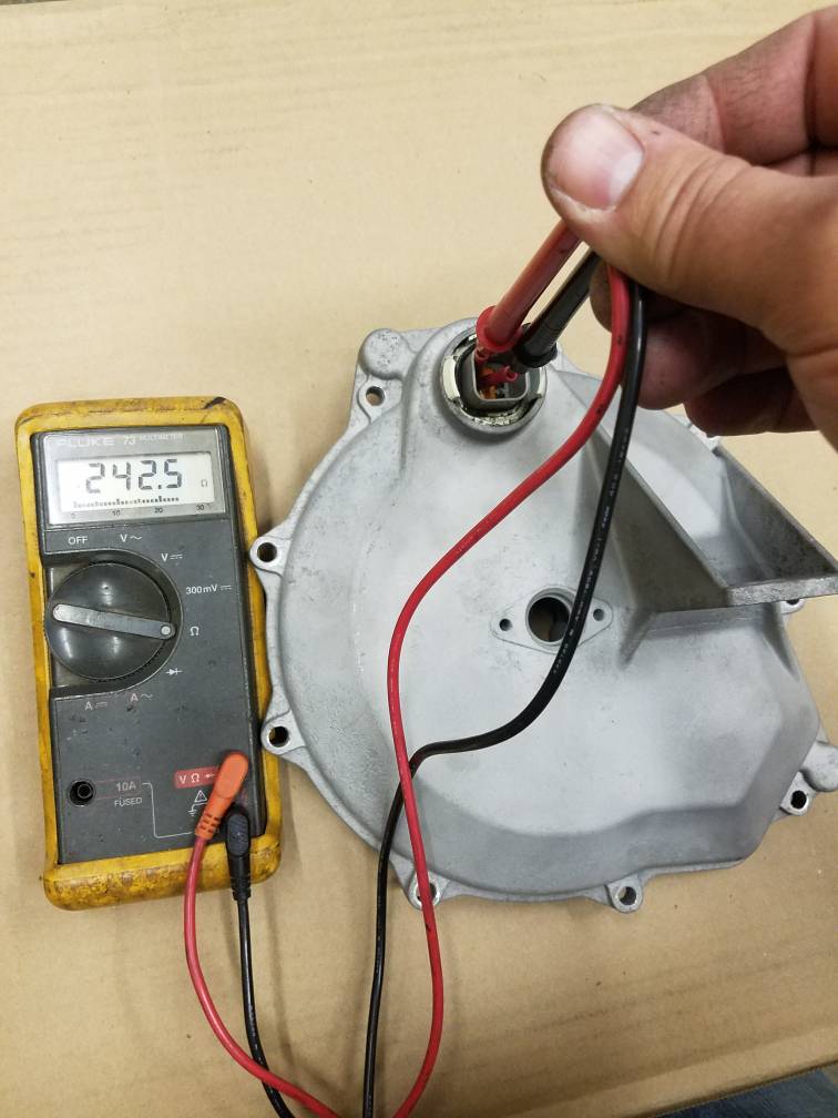

"Trigger Coil STATIC TEST : CONTINUITY 1. Disconnect the stator / trigger coil plug at the engine magneto cover. Connect the 6-pin mag- neto test harness (P / N 295 000 136) at the engine. DO NOT connect the other end at the boat's harness. 2. Connect the multimeter leads as shown (BK / YL to one meter lead, YL / WH to the other lead). Resistance should be approximately 242 ohms (± 10%)."

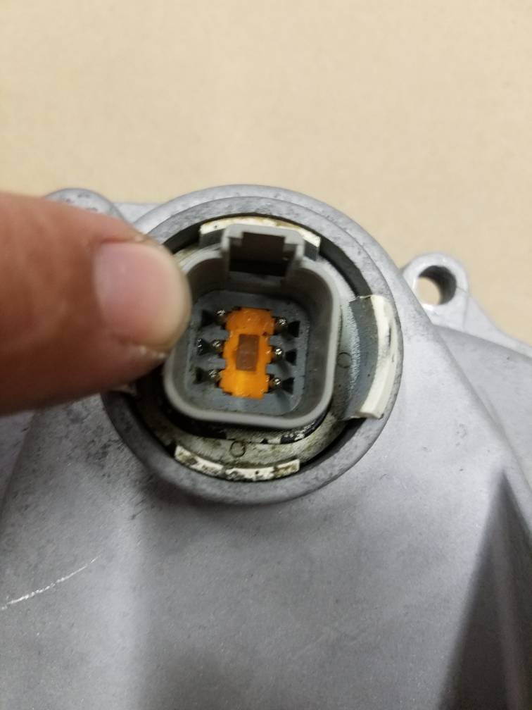

Anyone have a test harness they want to sell/ loan? Its virtually impossible to get test leads back there to the appropriate pins. Only room for one arm and you cant see shit

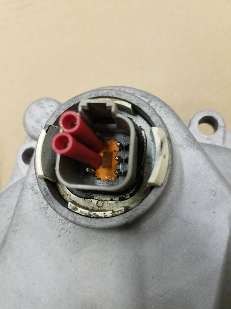

Get 2 red butt splice connectors. Lightly crimp 1 end. Disconnect the harness. If you're looking at the front of the engine it's the top left pin and the one below it. Insert the butt connectors. Use your meter to check the resistance. It should fall in the required range if it's good. The ONLY pin that should have continuity to ground is the 3rd pin on the left column. If ANY of the others do you have a short.

Ok Update: I wasn't able to get the damn connectors to stay on the pins to check the trigger. Sat up all winter.
