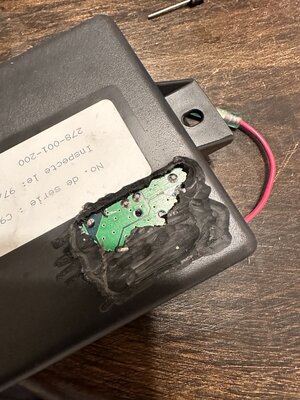

1997 Seadoo GTX bad mpem?
I mean, normally closed switch!
That might be my problem because I’m pretty sure it tested and normally open switch
I ordered some new diodes for my board and I’m gonna try to replace them before buying a new board!
