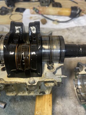

M Mem1guy Premium Member Premium Member Mar 13, 2023 #27 Alright, I got her opened up but haven’t pulled crank out of case yet to check bearings but here are some pics. Let me know what y’all think. Attachments 7F41184E-67D0-4338-B7DB-BCF1B8FFFF7D.jpeg 270.7 KB · Views: 8 8106564E-992B-469C-A928-FEAB9AF81F0C.jpeg 318 KB · Views: 9 81274E82-3976-4BEA-B831-03286EFA97EE.jpeg 319.7 KB · Views: 9 5663CBB0-115D-4793-B644-F89B4DAB94CC.jpeg 348.9 KB · Views: 9
