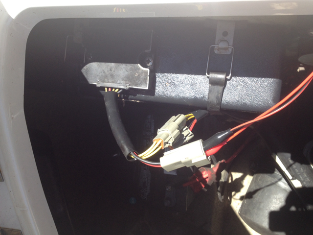

This is how I am attempting to test my rectifier output with the boat running- With my voltmeter hooked up directly to the DC output of the rectifier. I get a 0V reading. Should I expect to see 13 V- 14 V with the voltmeter hooked up in this manner?
Nope! I learned (after the fact) that the regulator puts out next to nothing if it's unloaded (not plugged in, or if the circuit is broken somewhere). Mine ended up being a fuse. A dam fuse. My fuse tested good with a basic continuity test, but it wasn't letting any current pass through. I found this after overnighting a new regulator...

I think I found my problem:
I changed out the 30 amp fuse and then got 14 V at idle. After that I swapped the fuses again to verify that was the issue-I got the usual 12.3V/12.4 V. Then I put the new fuse back in-12.3V again. Huh???
Then, with the boat running, I applied a little torque on the fuse while in the fuse holder and watched the voltmeter. While applying the torque, the volts instantly increased to 13.5 V-14.0 V. When I let the torque off, the volts went back down to 12.3 V. I could make the voltage increase or decrease like a switch. I've read a thread or two about the fuse holders being cheap and problematic. When I had the fuse in my hand, I could feel it getting hot. That was some of the complaints I've read- a melted fuse holder.

I wrapped sandpaper around a fine tip screwdriver and cleaned the fuse holder contacts. Then I pried them closed to create tension on the fuse. I'll call it good...for now.
