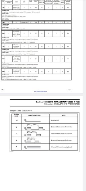

I found the section for fault codes in the manual. It gives beeper codes as well. I just confirmed a beeper code 6, its a 2 second beep every 15 minutes. However there is no listed codes for beep 6. Has anyone heard of this?
I looked in my 2005 manual, section 4 DIAGNOSTIC PROCEDURES, pages 81-103 and found no mention of 15 min beep nor beep 6, where are you getting this ?
I missed it,you are correct, sorry.

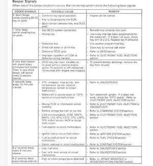

and from a 2009 manual:
