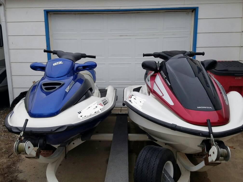

Ok...so I know it was a no-no, but we bought the gtx without riding it and non running. The seller got it out if storage the night before we were to go look at it. It wouldn't start, but my fiance still wanted to go look. The seller wanted to postpone it till he had it running (don't think he was scamming as he wanted it running before we looked) he claimed he went and made sure the fuel was reaching the fuel bar and that there was spark...I can verify fuel to the fuel bar as I took it off last night to clean it and spray cleaner on the injectors. It cranks and wants to start but won't. So now where should I start my search? Was going to try a different battery and clean the RAVE valves possibly tonight.

We got 2 skis and trailer, paid a little over 4k for everything, the Honda runs great with 60hours
