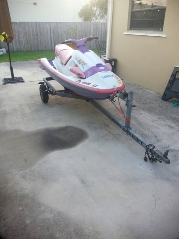

I just purchased a 94 waveraider 700. I brought it home and it wouldn't start or even turn over just clicked. I was able to free up the motor I cleaned both carbs and put fresh fuel. It fired rite up. I finally got it to idle perfect at 2500 on the trailer and 1500 in the water. Now when it's on the trailer it revs to 7k. Sometimes it hold it for a second or two after releasing the throttle. But once it's in the water it won't pass 3k even with throttle completely open. It idles fine and is ok with partial throttle until 3k rpm but anything more than that and it doesn't do anything just feels like it's being limited. Any ideas will be greatly appreciated. Thank you
