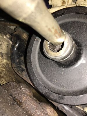

I had a guy bring me a 1996/97 GTI. ALL of the engine mounts the rubber separated. Sumbish was so misaligned it was unbelievable. Whole engine rattled. I rebuilt the carbs and lined it up spot on... checked everything of course. Ower is a car mechanic and it is his son's ski. I told him. This thing is gonna come apart but ride it till it blows. The following summer he called me and told me the carb bolts were loose. I laughed and said, gotta be a whole bunch of stuff loose the way that engine is vibrating. Told him to keep an eye on things and check exhaust bolts for sure. 3 years later they are still riding that thing !!! LOL Go figure. When I pull a pump I check alignment. :D 95% are a good bit out of alignment.
I think this was the engine. LOL My align bar is in position and.... it ain't slidin in there. :D
Lol...that's crazy. I always figured there are tolerances built in that are acceptable. But then you hear stories like this that beat all expectations and make these machines sound unbreakable.
I will just assume this is one of those 1 in a million cases of a seadoo that just doesn't know it was supposed to fall apart and head to Seadoo heaven.
On another note, my engine was off about the same amount as in your picture and that caused the splines to strip. I was lucky to have caught it when I did because I figured ones more outing and it would have started to slip and leave me stranded. There were almost no splines left and tons of play.
