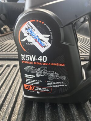

Here’s Operator’s Manual, which is where I got the 2.12 US Quarts. Also, I’m guessing this is wrong oil, it’s what they steered me to when I bought the oil filter at dealer.

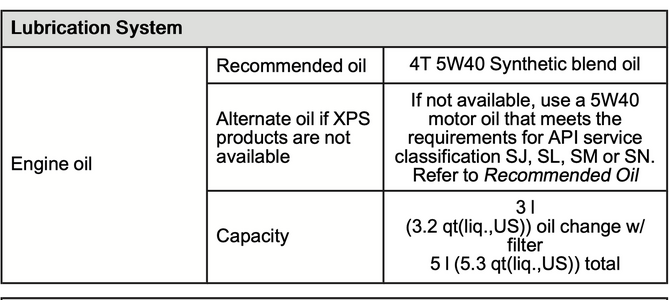

Well you have the right oil and the 169 KW = 230 hp so that's right also, not sure what manual your looking at, below is off the Seadoo website for 2022 Seadoo GTR 230Screenshot 2023-10-10 at 16.32.13.png
I am pretty sure the operator manual for your ski is messed up, they transposed the lubrication requirements between the 900 and 1630 motors. You will find the above chart in your manual under the 900 ACE specs. This would not be the first time I have seen an operators manual messed up. I don't think BRP hires Seadoo engineers to publish their manuals.

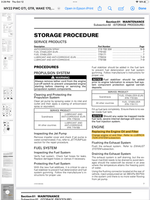

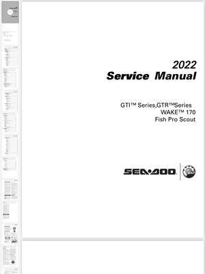

So, bought a service manual online. 291 pages, seller says it is what Seadoo supplies. Please take a look at screen shots attached. I highlighted where it says refer to the Lubrication SubSection for oil change procedure. But Lubrication Sub Section doesn’t exist in index. When you search document, nothing. I am wondering if this is a plagiarized half done attempt or if this is really what it is. Thanks!

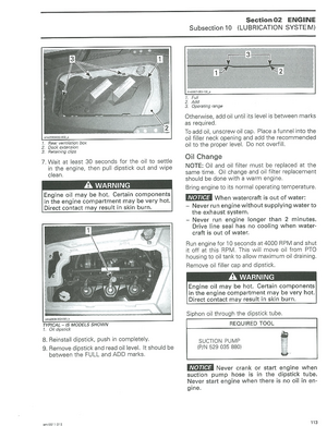

Screenshot 2023-10-12 at 16.58.22.pngThis is where the oil change info is in my pirated 2011 Wake Pro Service Manual, I do not have access to your 2022 service manual so who knows. Remember to support Right to Repair legislation any chance we get, it would alleviate this piracy BS.
I didn’t know that. Still, I am somewhat surprised documentation is wrong in the manual. Looking at their Corporate Mumbo-Jumbo Webpage they are focused upon all sorts of global goals. You would think Quality would be one of them. Looks like only 4 of 12 plants have any type of ISO Quality in place. As to the Service Manual maybe that’s a result of being “pirated.” I may buy from a different source just to see.
