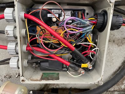

Helping out my brother-in-law with his "new" 1997 Seadoo Challenger with the single 787 engine.
MPEM is behaving very strangely;
  • At power on, you can hear a relay click on the MPEM, and power is supplied to gauges immediately,
  • Even after 33 seconds, sometimes, the power is still present, i.e. the timer to save battery power does not kick in and turn off the gauge power,
  • If the key is placed on the post, sometimes you will receive two beeps, sometimes just one,
  • cleaned and checked the DESS post all the way back to the wires going into the MPEM, all good, reed switch in the post is good and consistent, so the post has NOT been replaced,
  • If two beeps are heard, the engine will usually start after a few seconds of cranking, can run for a few secs or even up to you push the stop button or pull the key,
  • when it does quit on its own, it seems as if you have pushed the stop or pulled the key, power stays on the gauges, but will no longer beep or crank, even if the key is removed and replaced, no beep,
  • Need to remove power to the battery for a few mins and try again, if the relay click is heard it is usually good to try again, but sometimes no click is heard,
So far we have done . . . .
  1. Cleaned and checked all cables and wires (connectors and 0 ohms resistance in wires), confirmed good grounds and no corrosion,
  2. All fuses are good, no blown ones, just to be safe, put known good fuses on the MPEM,
  3. Ran new positive and ground wires from battery direct to MPEM,
  4. Tried multiple keys,
  5. All the pins and connectors for the large plug going to MPEM have been cleaned as well,
  6. Seems to be more intermittent when it is cooler, more stable when it is warmer,
  7. Beginning to think there is a faulty component in the MPEM power supply, but the unit is not welcoming to component surgery due to all the potting/epoxy encasing it. I have no reluctance to perform component repair, as I have done so on many older circuit boards, this one just has the challenge of the epoxy on everything,
  8. There are services which will take an MPEM from a PWC with the 787 engine and adapt it to work on the Challenger, but those are about 1K USD,
  9. Considering finding a used 787 MPEM from a 1997 GTX (~500USD), adding the connectors to match the Challenger harness, or . . . perhaps one of the ArielTek SD287s which is an aftermarket MPEM for 787s (~300USD) and adapting it for the boat.
There are statements that the adaption of the PWC MPEM to the boat will render the neutral start switch inoperative, but if the switch is wired in series with the line to the starter solenoid that should re-enable the safety feature.
I could not find any references to anyone using an aftermarket MPEM in a Seadoo boat, but I see no reason why it would not work with the 787 in the Challenger, am I missing something?

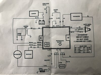

using the wiring diagrams from the new MPEM and the boat, I cut out the old MPEM and crimped in some bullet connectors so the new MPEM could just be plugged in. Even was able to preserve the safety switch to ensure the boat is in neutral when starting!!!
The boat started and ran great!
Issue now is that when the rectifier is connected, it blows the 5amp fuse at every start, replace the fuse and it starts again just fine, replacement rectifier is on order…..

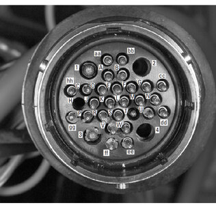

Sounds like you are asking about the continuity check for the cable/connectors, you can do that with a digital multimeter on the resistance setting. Connect one probe to the wire from the MPEM, and the other to the lug that connects to the coil.
Resistance should be ZERO Ohms.
In the case of the 1997 Seadoo Challenger the coil is in the same case as the MPEM so no harness between the two.
Double check all your grounds are good, from battery to engine/starter, and to the coil, bad grounds can cause all sorts of issues, on PWCs and boats!!!
Sometimes there will be corrosion inside the connector boot, a continuity check for the wires, connectors will identify that.
can you share any wiring diagrams you might have? I've got a 97 challenger single engine that I am struggling with.
I at my brother-in-laws, uncovered the Challenger from a winter nap, put on the key, cranked it for 10 secs and it fired right up with the Arieltek unit.
As far as the diagrams, I just used the diagram from the Arieltek manual, the wiring diagram from the back of the Challenger service manual to match up the wires. I can pull the diagrams off my computer when I get home.
