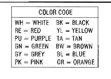

hawker Member Dec 18, 2023 #1 Hi! I need a wire color diagram for a GTI 130 (2009), where I found to download? Or anyone can say whats the colors of the water temperature sensor for I check if correct!

hawker Member Dec 19, 2023 #3 skiasylum said: There in the service manual for each particular ski.View attachment 64657View attachment 64658 Click to expand... Thanks!! I found the problem!! (P0337)! The sensor is broken! I not read 190-290ohms! Before I thought it was the connectors changed! Water temperature connector replaced with the CAPS sensor! But no! the problem is the sensor!
