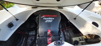

My oil tank on the engine looks low? See Pic. So today I am going to open the cap on the tank.
I am going to look inside at the position of the magnetic float. I am going to find a wire and see if it is at the top.
Then I will start the engine and hopefully the tank will start to fill and put cap on when full.
See if that eliminates the beeping. If it doesnt.
Some options next. Consider replacing the tank, Look at the water sensor and water separator.
Any other suggestions welcome.

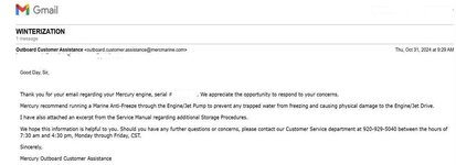

Mercury confirm along with the dealers that winterization of the Jet Drive system with Antifreeze is recommended. The information in this email really should have been a point in the attached Service List for the Jet Drive System .
Anyway - it only took 10 seconds to do and an hour of prep. I put a Rule bilge pump with output hose attached to the flushing port. The pump's two leads going to a battery. I connected the leads it started pumping in the RC Antifreeze and I started the motor. Engine ran 5-10 seconds until lots of RV fluid was coming out. I stopped the engine and disconnected a lead off the battery.
