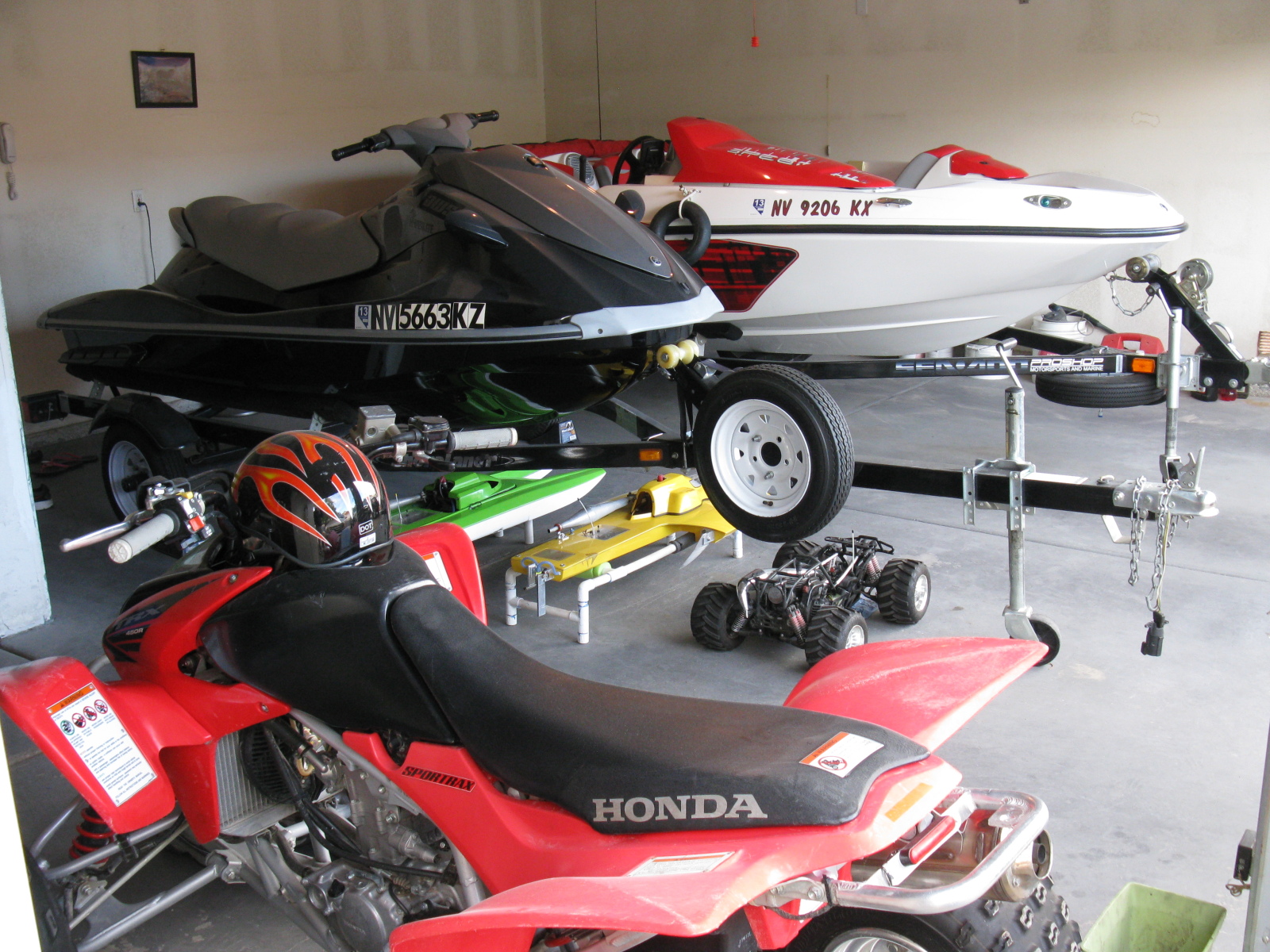

I store all my toys in the garage, no matter how bad of the weather, nothing could hurt them.
Now that's a toy shop!
