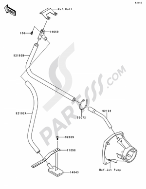

On pretty much all jet-pump PWC's, there is siphon bilge drainage system.
That system sucks out any water through a pickup at the bottom back of the bilge (on either side of the pump tunnel). From there, a hose (or two hoses) goes up to the top of the engine compartment, above the waterline, and then loops back down to where it connects to the jet pump nozzle. The connection is piped to a place in the nozzle where the pressure is actually negative due to the way the water flows through the nozzle (venturi effect). You can usually see the little pipe(s) sticking down and out the nozzle near its end. The negative pressure induced by the water flow siphons the bilge pickup to actively drain the bilge (whenever the PWC is running).
So if you drove the PWC just before you put it on the trailer, it could have actively emptied the bilge then.
The same effect explains how you can drain a boat by opening the drain plug at the lower bottom of the transom while underway - the water flowing past the back edge of the transom creates negative pressure there (or an air gap if up on plane). So if your drains were open, they would have also been draining the bilge while you were riding before putting the PWC on the trailer.
(diagram from an older Kawasaki parts manual)
