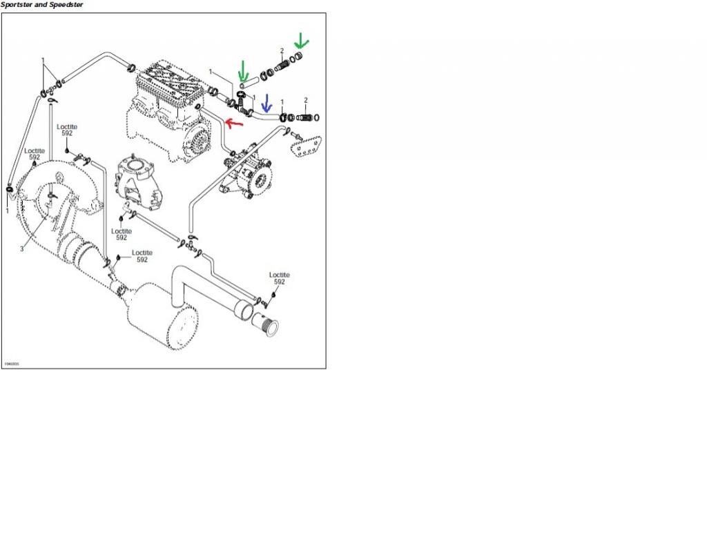

Welcome to the forum, I think seeing the factory manual diagram might help you understand better how all the cooling system hoses are routed. When you start the engine and use a hose to supply water from the transom flushing port all you are doing is back flushing the normal route of water where it enters the head.
You can see in the diagram where I drew the red arrow that is your normal incoming supply line from the jet pump, when on the trailer and hooked to a hose water is coming in from the flusher line with the blue arrow and where it T's into the top flusher line with the green arrows that is the reason for the cap on top of the engine bay. The rear flush line can be pinched before the T and you can make use of that top plugged cap to pour antifreeze into the motor for winterizing.
That's it, the only thing that changes is the side of the head water back flushes in from and subsequently you will have water discharging from the jet pump supply line and all the exhaust side hoses and tell tale line function normally to discharge water when flushing.
