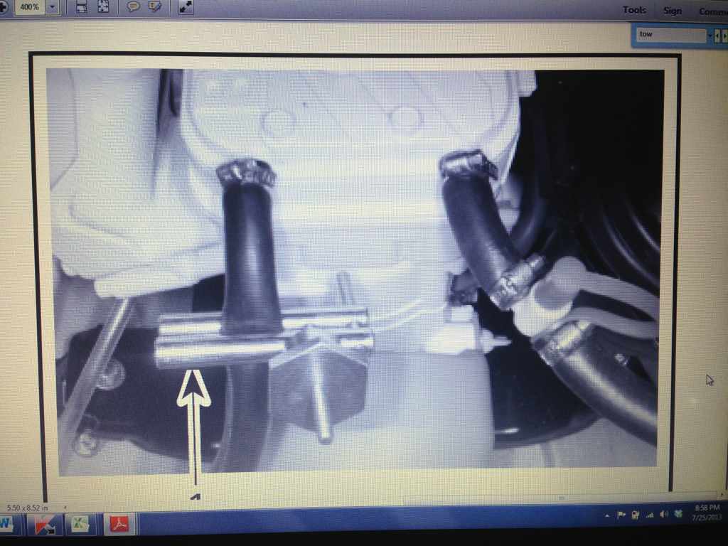

The manual for Ski's states: "Pinch the water supply hose from the impeller that goes to the engine."
Here is a picture of it from a Ski manual, it may be enough for you to figure it out...
Thank you!
Looking at your picture I can't tell which hose is coming and which is going,,, so I played it safe with a picture and text...
Someone will know for sure as I would think they are set up the same way as far as inlet and outlet goes. I just don't know which is which.
It is just a matter of tracing the hose back to the pump now...

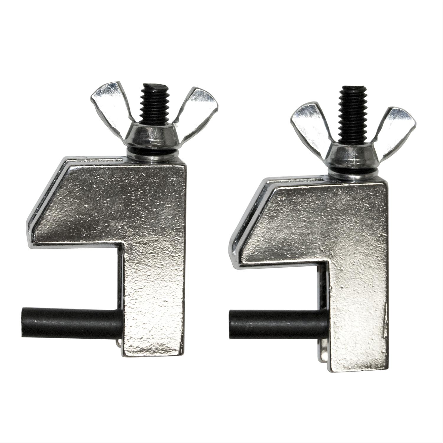

I have the plastic plier looking ones similar to the Amazon ones above. They do not work very well if you need a tight leak proof clamp as they are too flexy. Get the metal ones from Summit or other location.
