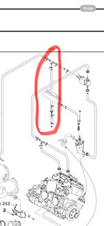

I just bought this project 2001 seadoo gtx di and can’t figure out where these hoses go one in picture that’s circled and also where does the air cleaner vent on top go too and is there supposed to be a battery vent line? Thanks!

The bottom end doesn't go anywhere, the little device in line with the hose is a check valve. Just make sure it works. They do fail over time. I have only had one fail though!
I think the line with the check valve on the bottom goes to the vent connection on the balance shaft oil reservoir.

No, that line in your picture goes all the way up front to the fitting on the oil tank on the "fill" nozzle.
I line you questioned about a connects HERE.
