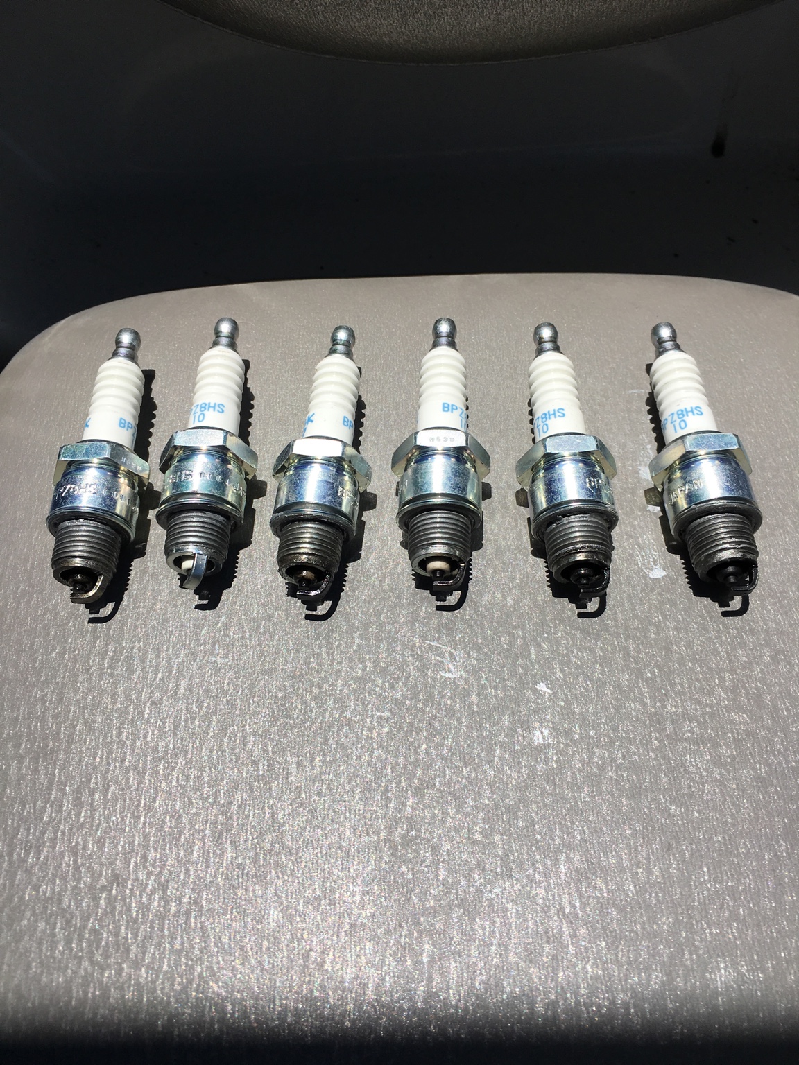

Okay... Is it possible it's only running on 2 cylinders. I got my inline spark tester today and it only lights up on cylinders 4&5.
Plugs from left to right 1-3-5-2-4-6
Cylinder 3 doesn't even appear to have any fuel on it...
Yes... it could be ruining on 2 cyls... but it's normally rough at idle.
#'s 3 and 2 (if I read your post right) aren't firing at all.

Yes. From the looks of the spark plugs. 3 & 2 don't seem to be firing at all. These spark plugs were just replaced and engine has only been run during testing since.

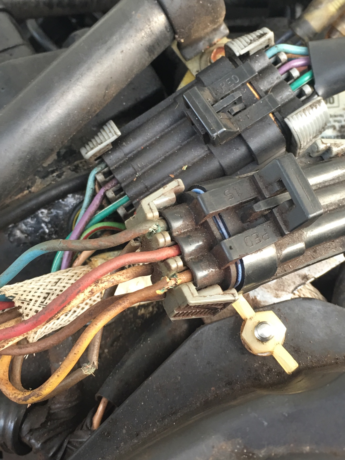

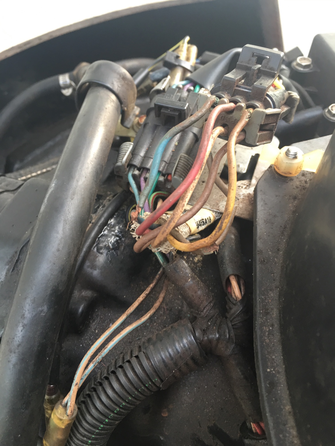

A bird almost pooped on my head today but it hit the flywheel cover instead, and then some scorched wires caught my eye... the wires coming from the trigger assembly are very corroded just before the harness.
1) could this be causing my problems?
2) Can I repair the wires or will I need to replace the entire trigger assembly?

1) Yes. But post a pic so I can see what wires they are.
2) Post a picture, and I can tell.
I didn't take a picture but I will take one tomorrow and post it. I think they're all connected so I dont think thats it but I would still like to repair if possible.
If thats not it I'm thinking the control module maybe?!
The tester is fine... but those wires are ugly. AND... I'm guessing it has something to do with your ignition issues.
I would pull the pins out of the plug, and replace the bad sections of wire.

The corrosion goes a lot further down the wire than I originally expected. I got heat shrink tubing and will be repairing the wires today.

Well... it won't help, and it needs fixed. But, those 2 relatively clean pugs, is telling me it's not firing at all on those cyl's.
