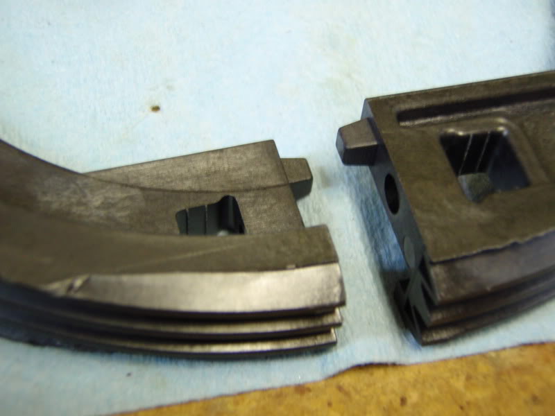

If you really want to keep the oil system... there are some inexpensive bore scopes out there. Harbor Fright has a few... and if you look on ebay... I think I've seen a few that go into the USB port on a laptop.
If you do try to look in there.... the top is the old gear, and the bottom is the new. You can see that the old gear, is smooth/shiny, and the new gear has a fiber texture in it.
wow, from those pictures there's definitely a difference.
the only reason i would like to keep the oil injection is convenience. But i will not put my boat at risk for that. Do these gears slowly wear out? or do they look brand new until they gernade? Depending on how big of a process it is, i might make it a regular inspection item........

...... Do these gears slowly wear out? or do they look brand new until they gernade? ......
That's the real question. We don't know for sure.
I bought my boat with a bad engine. It came from a rental shop... and I figured it was a oil issue. In my case... I was wrong. My engine threw a rod. AND... my oil gear looked perfect. It only had a small amount of wear.
The general summery is... the bushings and shaft tolerances are too tight from the factory. That's not an issue until you overheat the engine. When that happens, the shaft gets tight, and the load on the gear is TOO high. In turn... it wears it to a failure point. The new gear can take the extra load. But... if you don't ever overheat your engine... it shouldn't be an issue.
On this forum... we have seen gears, that were almost gone... but the pump was still moving some oil.
If you look in... and the gear looks good, and the shaft isn't galled... it should be fine. But... if it's the new gear... that will indicate a rebuild.
