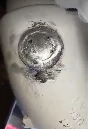

Well, it took 26 years, but one of my welch plugs is leaking - 3 small holes. My (64 year old) back objects to removing the pipe to have it welded, so I'm going to JB Weld it. Is the best option, the JB Weld SteelStik? I see some people JB Weld a quarter or piece of aluminum over the plug. Seems like a quarter should work nicely for added strength. I'm assuming with a layer of JB Weld between the aluminum and the quarter, the nickel cladding on the quarter should not cause the aluminum to corrode. Is that the way to go, or should I just use the JB Weld alone?
Use aluminum. It is a coefficient of thermal expansion thing. If the two metals don't expand and contract at the same rate, they will rip the JB Weld off. I only had a JB repair work once and that was on a motorcycle carburetor body and it used an aluminum disk. There was no pressure on it. Did you consider solder like a gas tank or radiator repair?
Straight JB weld. Nothing else needed. You're not adding anything if you put metal over the top. Clean it good, let it dry and use the 24 hour JB weld. You'll be good for many many years. I'd do ALL of the welds... at the same time or you'll be chasing leaks. Good Luck !!

Agreed no "patch" needed. I was covering a hole we drilled to unplug a non-replaceable jet so it was far larger than a pin hole. I have never understood the mystique of JB Weld. It is just epoxy with some filler. The biggest issue is getting stuff to stick to aluminum. Clean, clean and clean some more. Give the surface some tooth if you are not worried about looks. I have used adhesion promoter on really smooth stuff. Or just slap something on and see if it works. It probably will.

Anyone use the jb weld high heat putty? I have leak that just started and was hoping to sand and slab putty over it so i dont have to take pipe.off. mine is leaking out the bottom side. Up for suggestions to avoid removing for repair.
