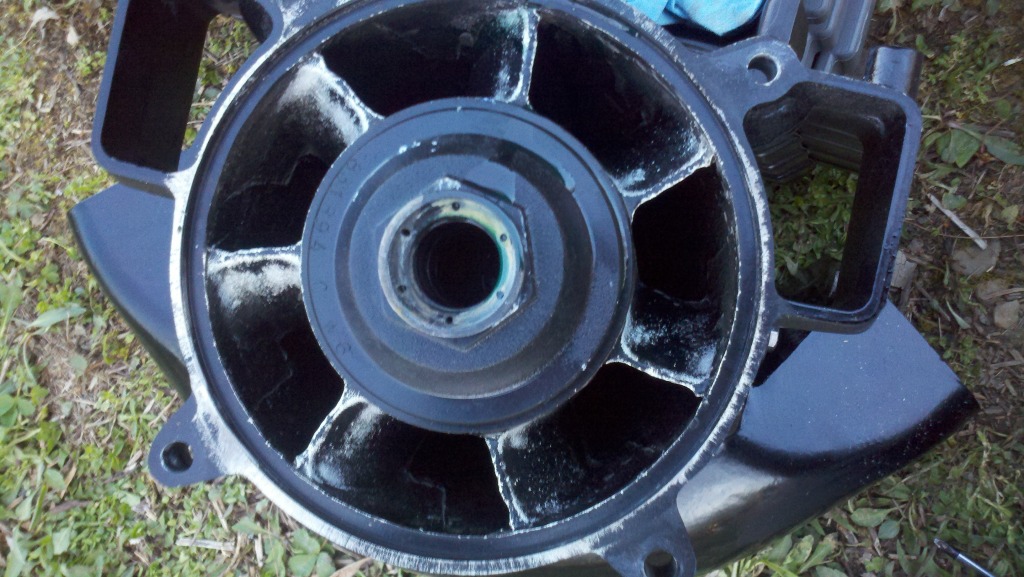

hey did you end up getting your wear ring refinished is this what you were talking about? im def gonna send my impeller there here are some pics of what mine looks like.. Where did you get the special nut driver? thanks
ANY OTHER COMMENTS APPRECIATED

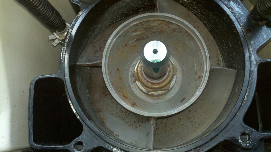

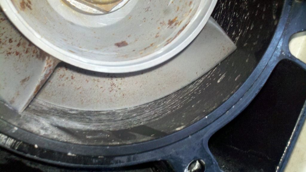

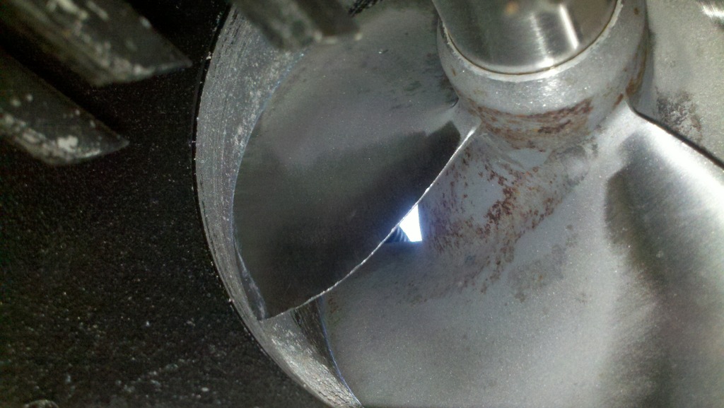

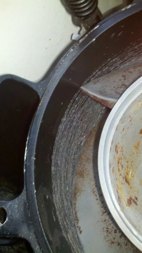

I am back on for sending my Wear Ring, Impeller and Stator to impros. Should be getting it sent off next week and have it back within the next 2 - 3. Hopefully before the May 24 long weekend.
Got them sent off yesterday.
Same situation
wow yeah a bit rougher than mine for sure! youll have a huge improvement it will def pay for itself in efficiency
Thats about my X-20 looks. Let me know what they charged. Im still temped to do the JBweld

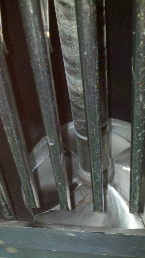

Koby, I see you are using the hydro-surge grate. Have you had any problems with it? The second time we ran ours we sucked up a beer can. I did some research and replaced it with a grate we purchased from eBay.
Not yet i havnt but i have read on the problems people were having tines breaking and sucking stuff up. I am interested in where there are aftermarket anything for the m2 merc jet systems though!! thanks
What company did you get it thru I cant find one I sucked up a ski rope. Try cutting that out on the water
