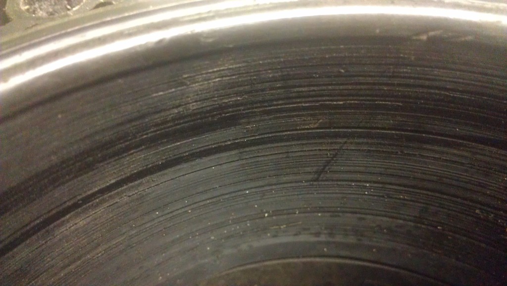

My 98 sportster would only do around 32 MPH. Will this cause an 8 to 10 MPH loss? I'm ready to put the boat back in the water.

As far as speed loss... I can't tell just from the ring. What was the clearance? Also, what was your max RPM. If you had a 10 mph loss because of a pump issue... you would be bouncing off the rev-limiter.

Once the boat was up to speed, it seemed to run OK. I can't spin the boat or anything like that. I think my max speed was around 32MPH. I was under the impression this boat (98 sportster, single rotax) should run around 42 MPH... Is that correct? The old ring was gouged very bad in some places. I can tell you I could fit a few pieces of paper between the prop and old wear ring. As for the new ring, the clearance isn't even comparable to the old ring.

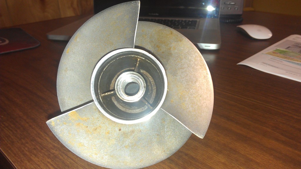

How's your impeller look? Make sure none of the blades are bent or the edges aren't torn up. To me, that ring looks like its gouged up from one side to the other. Not just in a typical wear pattern.
Well that looks brand new. Have you ran it since you put the new ring in? IF that didn't fix it, i would be looking into the engine. But without a good tachometer its hard to know whats going on.
