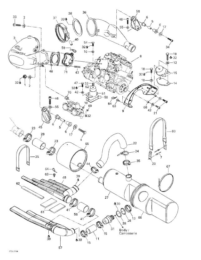

My 02 DI project has the o-ring style rubber gasket, however the service manual only show the standard gasket. Could this have been changed at some point? What sealing system is better, The traditional gasket or the rubber o-ring style?
Thanks, 68RT

The O-ring is the later style, be sure to use the diaper(#71) around that joint. What also funny is if you look at the microfiche on the cylinder, exhaust manifold explosion drawing they show the o-ring, but on the engine support and muffler explosion drawing they show the gasket.
Exactly the pictures I was looking at! Thanks for posting those.
