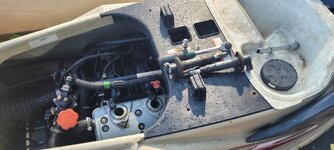

Have driven this summer 250km and this works fine, but if I leave it at the lake for a couple of days or a week or so, it won't crank over. Thought battery is drained, but now it seems there is fresh water inside the cylinders and that is why it won't crank. Have removed the plugs and they have drops of water. One can see water surface over the piston. Cranking plugs removed, water is sprayed all over (photo). Then install spark plugs back and go to a ride no problem. Sometimes cranks and starts ok, 3 times this far needs water removal by cranking without spark plugs.

Put the spark plugs back and drove half an hour, no problems. Left to the water for 4 days. Today pulled out the plugs, without cranking the engine first, and they were dry. Also cylinders were dry. Didn't try to crank and start the engine. Will disassemble the exhaust to see if there is any water.
