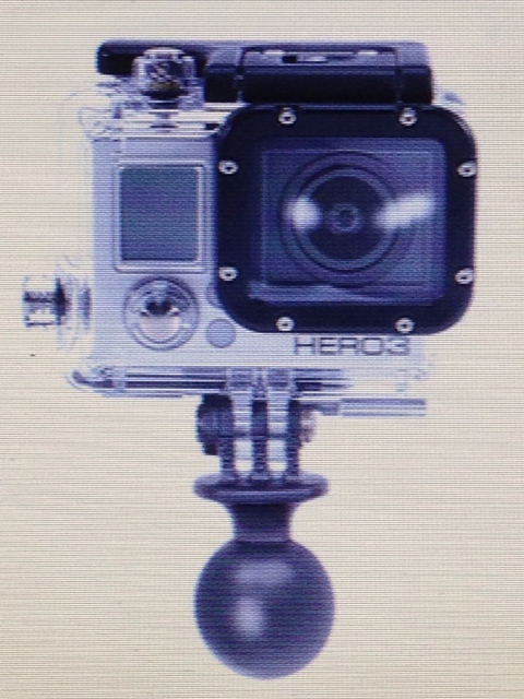

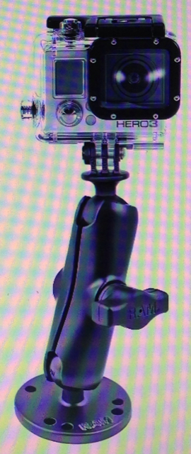

Many do use just the suction cup mount and love it. I am not that brave,,, I bought a flat base that has a ball on it. I permanently mounted the flat base to my ski and I use the RAM mount with the large wing nut style clamp. It works fantastic as it simply clamps onto the ball. In this case, it has a single wing nut and accepts a ball at each end. So one end on the ski (to the mount with the ball) and the other to the GoPro bracket made by ram which is also a ball grabbing system. You can pivot this in any direction and it si super strong and safe.

I drilled holes. I put a thin piece of rubber under it, use stainless hardware and flat and locking washer underneath. I put some permatex on the studs to hold the nuts from backing off.
They are in storage right now so I can't take a picture. But I think I have a spare mount here somewhere that I can take a picture of it.
Ok. Found it all online. Here is what I have. Here is the camera with the ball mount.
And here it is complete.
I also bought the "U-brackets" for my bike. I loosen the thumb screw and take it to my bike. I then bought the upper mounts for my GPS which works perfectly with the stuff for my GoPro.
Ok nice. Now where exactly did you mount this on your ski? Sorry for the 20 questions, I've just never actually seen a GoPro mounted on a Sea Doo before.
