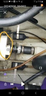

How do you turn the driveshaft by hand, 95 gtx , do you grab it with a locking channel and turn it? Is it counterclockwise looking towards the bow?
Remove the rear flywheel cover, remove both sparkplugs then turn the rear flywheel by hand. Direction really doesn't matter and no tools should be needed.
