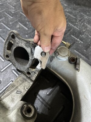

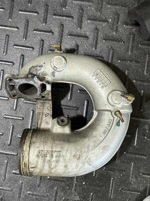

I have a 2003 Seadoo GTI LE which I recently purchased from the second owner. There was a crack on the exhaust pipe flange where it bolts to the exhaust manifold, leaking water. During lake tests, working on carb issues, that flange broke completely. I’ve found several used “tubed exhaust pipes” for sale. There is a wide variety of part numbers, all claiming to fit the 717/720 engine. Do I need my EXACT part number, or are there years where that pipe is physically the same, just numbered differently across different year models. Thanks in advance.
