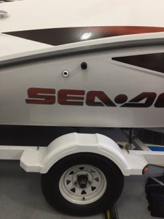

CSager: just want to confirm your bunks are carpeted. In your last pics, it looks like the bunks are bare wood.
They did look bare wood, and I see a carriage bolt sticking up, a major no-no. The hardware should come bottom up, unless you counter bore so the head of the bolt is below the surface of the wood.
Saw that too. That would definitely make it harder to winch the boat up by hand. I really hope that's an old pic or something.
Yeah. Forget making it hard to get on the trailer. I'm cringing that it's going to rub on hull, even if it's covered in carpet.
Agreed. I was just regurgitating what the OP said about difficulty winching the boat up by hand. The bare wood would absolutely make it difficult to winch up by hand.
It sounds like just backing the trailer in a little further is going to take care of things. I was thinking it was a little odd to have to adjust the trailer that is usually already set up, but I've never had problems getting them snugged all the way until this. Thanks everyone
Lol it's all good that pic was just for a reference for the bunks I had the boat out for holidays we just got back a few days ago. The trailer still had the original bunks from 2006 carpet looked ok but when we came back to camp we were just checking out the trailer and I noticed a little sag on one of the bunks. I pushed on it slightly and it was rotten right through! There was no replacements in our area but I did find sliders for bunks at a hardware store. So we replaced them with 2x6 treated wood and placed the sliders on for a quick fix I'll be going back to the carpet because the slides are to slippery for my liking but the boat sure does crank up easy!!! So check your bunks I never thought about them before but that would have been a disaster if one let go while loading!!
