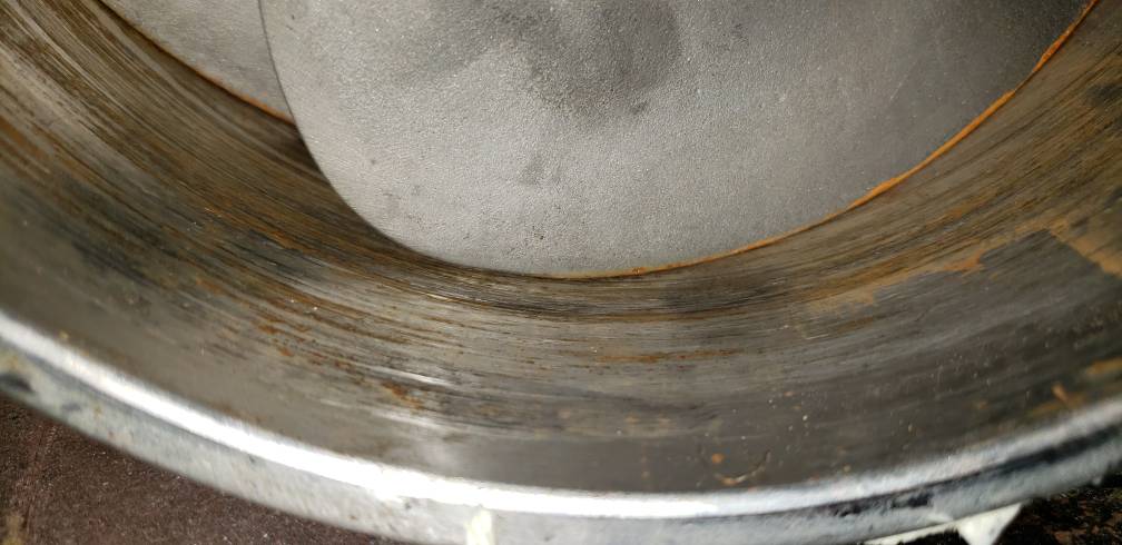

My first thought was PUMP. Since before the first ride, I did change out the impeller for one out of a 2005 GTX. This thing was MINT. The boat pulled like a beast with 0 cavitation. I do have a metal wear ring in this thing as well. When I checked the pump though, I found that it turns smoothly. I even put it on an impact gun and turned it over fast and it didn't make any noise. The impeller does however have some wear around the blades, like they've been grinding the wear ring. The wear ring itself has some markings, and both are rusty, despite both being SS. The thing turns smoothly and quietly, even at the speed of a dewalt drill.

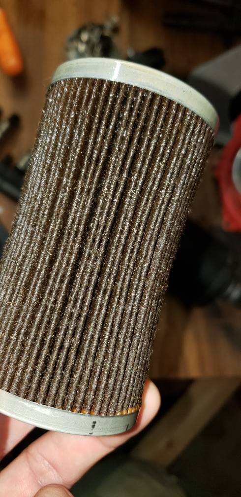

I started taking apart the engine, thinking maybe it's the supercharger. I pulled the SC, and it turned out to be just fine. Washers and bearigns in perfect shape. Spins smoothly, quietly, and no play in the shaft whatsoever. Next, I pulled the oil filter and found aluminum chips in it. I'm not used to seeing this much debris in a 4stroke oil filter, so I figured it's bearings. However, I pulled the plugs and they looked perfect (just like after I changed them). I then did another compression test. Got 130, 130, and 140. Interestingly, 130 belonged to the two cylinders which mattered the least during my initial problem that was "fixed" after I put in new plugs. Cylinder #3 had the highest compression.

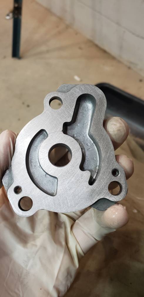

Anyway, I pulled the motor, and both oil pumps looked good, aside from some normal scarring. Looks like some of those aluminum chunks made it though there, but they're not destroyed. They definitely don't look new, but don't look destroyed either. Spinning the motor over with the starter sounds perfect, and I even saw a jet of oil shooting at where the SC gears would have been had I not had it removed. Turning the engine over by ratchet when it was out felt smooth and no play.
I got as far as removing the valve cover and making sure the valve train looks perfect, and cam lobes look good. I couldn't remove the large aluminum caps on the bottom of the engine (need propane to loosen). But at this point, I'm guessing pulling it apart any further would yield no more answers. I'll probably find that the bearings are perfect, just like they were in 2015, when I last had this engine apart to check bearings, install ARP flywheel bolts and replace all valves to bulletproof the engine. I wonder if it really may have been the pump all along. Could I have maybe sucked something up? What about that dry bearing noise? I wouldn't call it "grinding" or "growling"... it was like a bearing spinning in a race that was a bit too large for it.... Could that have been the sound of the impeller hitting the steel wear ring? They are both scrathed up, adn the impeller looks like it was rubbing against it. This pump was rebuilt about 150hr ago with a WSM kit...
