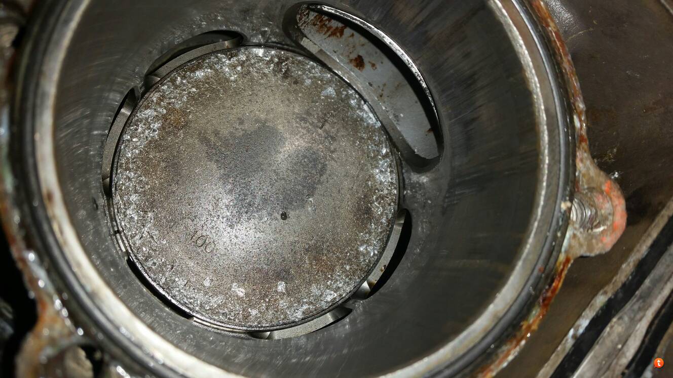

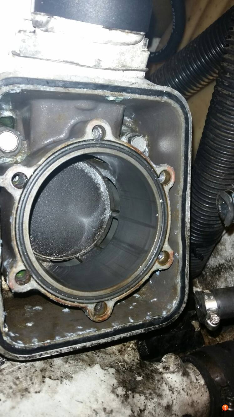

Well I got the head off and what do you know. Looks like snagged rings from the rave valve. There all chewed up. Put very minimal dimples on the head. The bottom end looks pretty good. But I'm going to rebuild the top end. So what do you guys suggest. How much should I bore it over. And how much power gain should I expect from it. I may as well add some other upgrades at this point lol
Stock is 82mm
Next is 82.25 with oem
Then 82.25--82.5--82.75--83mm if you go with wsm.
Id go absolute minimal boring.
So if they measure out to be 82.0 to 82.15, you migh get away with the 82.25.
82.5 is what I personally use if I have to bore but ive needed it in each case. Each time ive used the wsm kits with all gaskets needed included.
Get a measurement of your bores first and then decide :)

The previous owner said it was a complete rebuild. I'm not sure how many actual hours are on it. Every gasket looks to be brand new and pretty much every bolts been molested. The whole motor in general looks pretty clean for the year so I wouldn't be surprised if it was rebuilt. Maybe they just made a simple mistake and didn't shave down the rave valves.
Hate to be the bearer of bad new bro, but those jugs are already 1.00mm over. Next size it 1.5, if it were me I would not be going there. Either hunt down a set of jugs to get bored or send the engine in and swap it for a reman and let them worry about re-sleeving it.
Look at the lower side of the piston (@ 7:00) and you'll see the 1.00 stamped on the piston.
Gahhh. Damn it. Well I just seen a set of jugs with everything on ebay with wsm pistons and everything you need for a top end. So I guess it's a true complete kit. 289 after a 150 core exchange. I guess that's my only option at this point.
Rave valves on a 657? Are you sure you've got the stock engine in that ski? In either case I would suggest taking the easy way out, since this is not the first rebuild, get a rebuilt short block.

Just spend your money wisely. If you're at $550 to $600 for a top end and a complete reman is only $200 to $250 more, your best bet would be to step in that direction. Just don't over extend...... Hate to see you drop a top end on only to throw a rod cause some metal fragments scattered into the bottom end.

Yea that's way over double lol kind of out of my price range for now. Is there a way to inspect the inside a bit more to see if there's any shavings? It looks like the Pistons got torn up to a minimum. But you are right it's always better safe then sorry. There's still a lot that I have to do to the ski and don't want to end up paying 3k for a 1997 lol
I hear you that you don't want 3K into a 97, but it will last you for years. I'm probably the worst guy to give you advice on which way to go. I dump new parts into my stuff at once, but I want to ride headache free and not wonder then the hammer is going to drop. There are procedures in the service manual to check the crank against, the cases don't look nasty inside so you might be OK. Somedays you gotta roll the dice, I'm not too much of a gambler.
