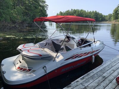

I just upgraded from a 2000 Challenger 1800 with a Mercury 210HP to an absolute mint condition 2004 Speedster 200 310HP.
One of the best features of the Challenger was the throttle boost (via cable) on steering full lock… it made it possible to maneuver that boat anywhere at low speed… quite incredible actually. But now with the Speedster 200, it does not have that throttle boost… so slow speed maneuvers are a bit softer and course corrections are a bit slow… I have adapted the use of blipping the throttle on one engine (or the other) to help kick the back end around quicker, which works in some conditions but not all.
So I was wondering if anyone has tried the Thrust Vector fins on these boats and what your experience has been?

Nice looking boat! I have same one. Have not tried the thrust vectors. I just play with the throttle speeds.
I did add the High Tec ride plate extensions to eliminate the porpoising and it has changed how the boat handles at plane speeds. Didn’t really affect reverse, nor did it improve low speed handling.
