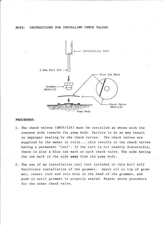

This is what we talked about with the check valves Tex, sounds like you got everything else squared away on your carbs up to this point the curve isn't nearly as defined as the picture shows but you'll get the idea the mark always goes up when they have a blue or green ink line on them.

4. Fuel check valves could have be upside down. Not sure if this occurred or not, but I had 2 extras and decided to go ahead and replace them. Making sure the marked surface was the top surface, important as the fuel check valves are concaved in shape.
