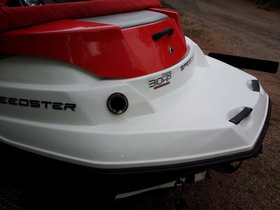

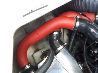

i;ve done about all you can do to these engines without going inside engine, i.e. value springs, cam, etc. I owned a 40; ft. Fountain boat with Bob Teague big block engines(2) loaded and always an issue with engines, etc. so i wanted my set up for OEM stock reliability. I'm in the 79's at sea level which will compete with most and can use as OEM, pulling kids, skiing, etc. and i use it for fishing. Have a removeable King Anchor on bow along with 93sv Garmin fish finder with Live Scope. I use a Fishing Specialties (in Colo Springs) transducer pole setup in the middle of the bow. It, like the anchor is removeable when not fishing. I use a Ice Hole fishing power box that holds a 32ah Aped lithium battery that powers all fishing gear, also portable and removable when not in use. It is in the storage box by the helm when in use. Its a self contained unit, so no worrys re: boat battery. It actually can go in shallower water than the more serious bass boats due to jet drive vs. outboard. I use the 6-12 ft. poles that came with King Anchor to move around quietly with no motor until moving.
