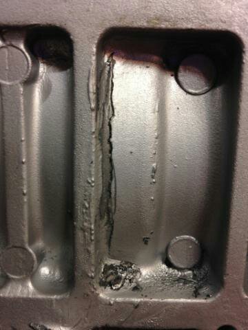

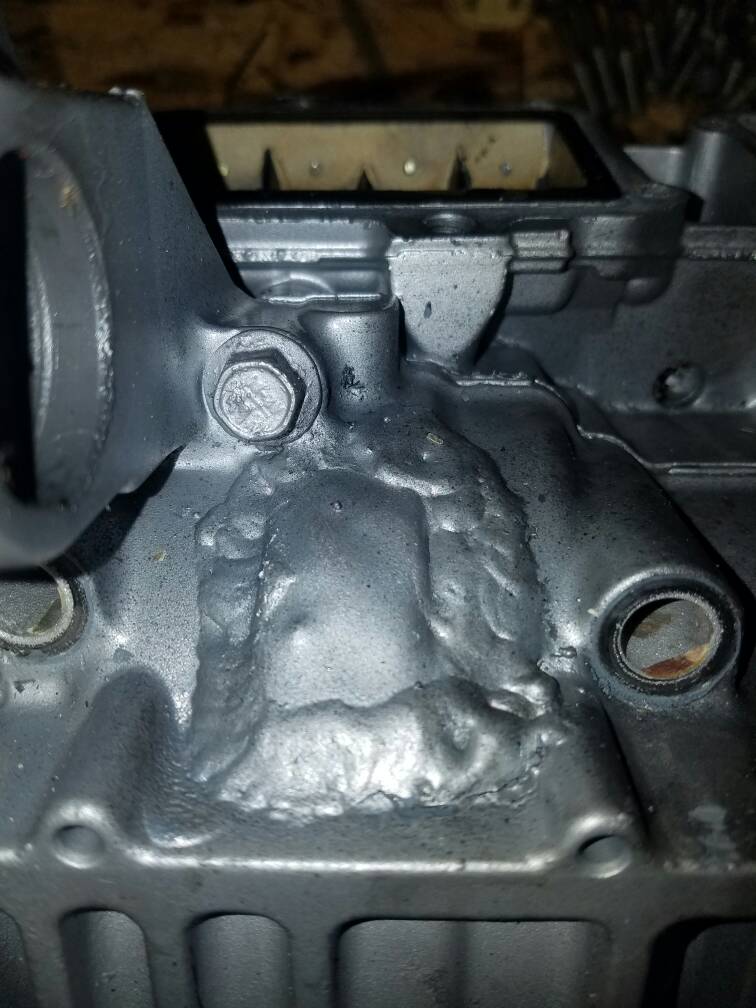

So I pulled it out of the container and this is what we found.
The weld looked like a 3 year old did it. The crack on the bottom was painted over. So I called Tom and my first question was do you pressure test all your motors? The answer was "every motor" so then we yelled at each other for about 30 minutes. All I could do was laugh because he had no idea what I had, he had not seen it yet. He finally agreed to take the motor back and fix it. I sent out a mint set of cases bc there was no way I trusted his repair work.

Then this spring this motor/machine got sold to me.
Nice weld job! Motor lasted a few hours, guy I bought it from stated to me ses wound not return his call.
