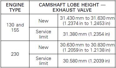

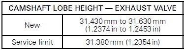

Greetings forum members. I'm in the middle of an engine rebuild on a 2017 GTR 230; while measuring the camshaft lobes and comparing to the specs in the 2017 manual, I found my camshaft was out of spec, or so I thought. I just happened to have the 2018 manual and there was a change. In the 2018 manual, there are two different tables, one for the 130/155 type engine, and another for the 230 type engine. That's missing from the 2017 manual. I was about to erroneously condemn my camshaft, and that's a very expensive part.
Example from the 2017 manual (only lists the 130/155 spec)

Example from the 2018 manual
