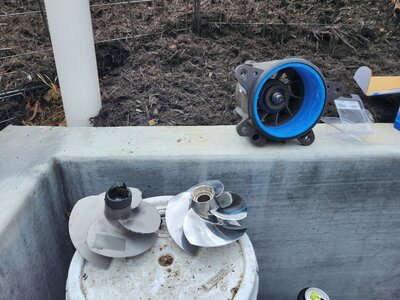

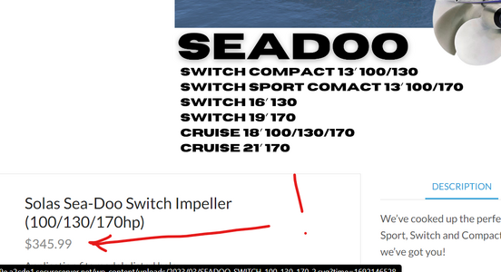

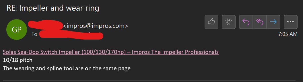

Okay folks! I've done industry espionage by playing dumb (because for this subject I AM lol) with several suppliers and finally covertly coerced them into spilling the beans! No more paying $350+ for our "hidden" impeller part number!
It would appear as if all of the following:

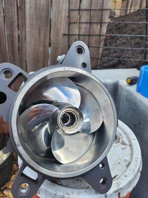

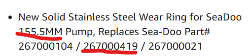

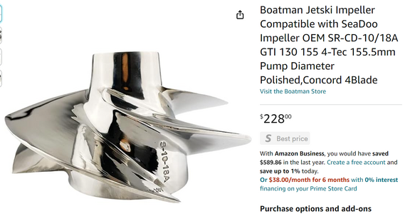

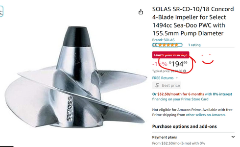

Use a Solas SR-CD-10/18! I was able to verify with an official Sea Doo exploded view, and lots of research on the web, that the OEM wear ring (PN: 267000419) is indeed 155.5mm!

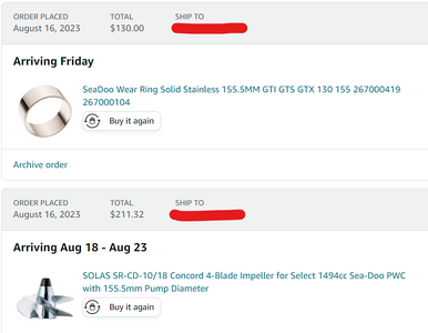

I was able to get the impeller AND a STEEL wear ring for less than what Impros wanted for JUST THE IMPELLER!!!
WOOHOO!

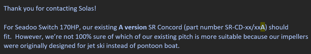

UPDATE!

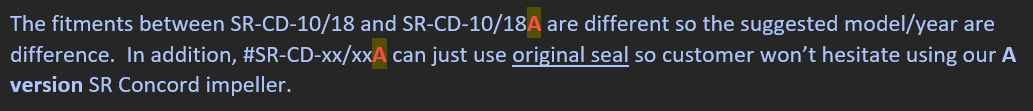

I contacted Solas just to make sure and they said I needed the "A" version of the impeller.
I sent them a reply asking what the difference is between the two. I'll post when I know!
