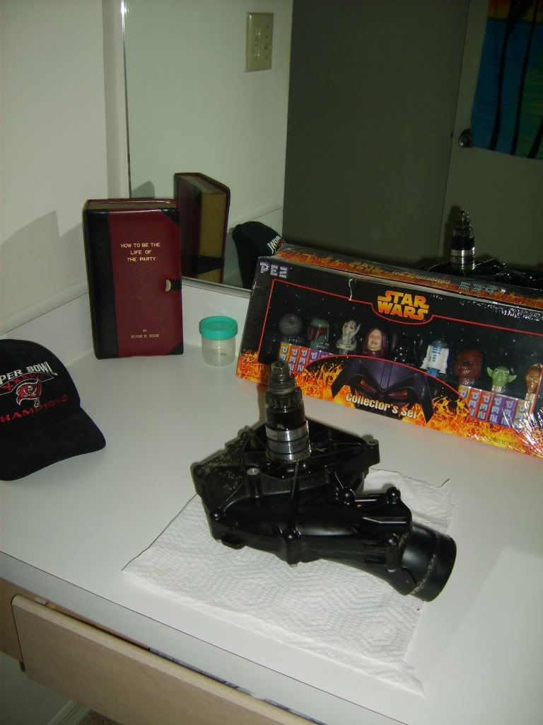

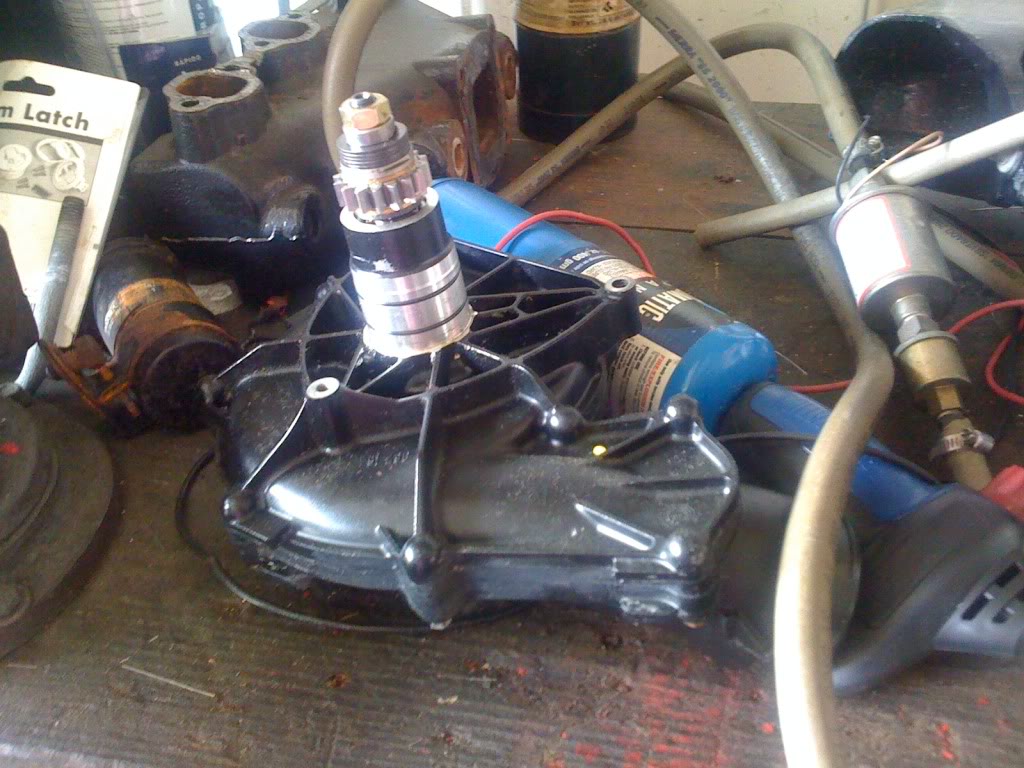

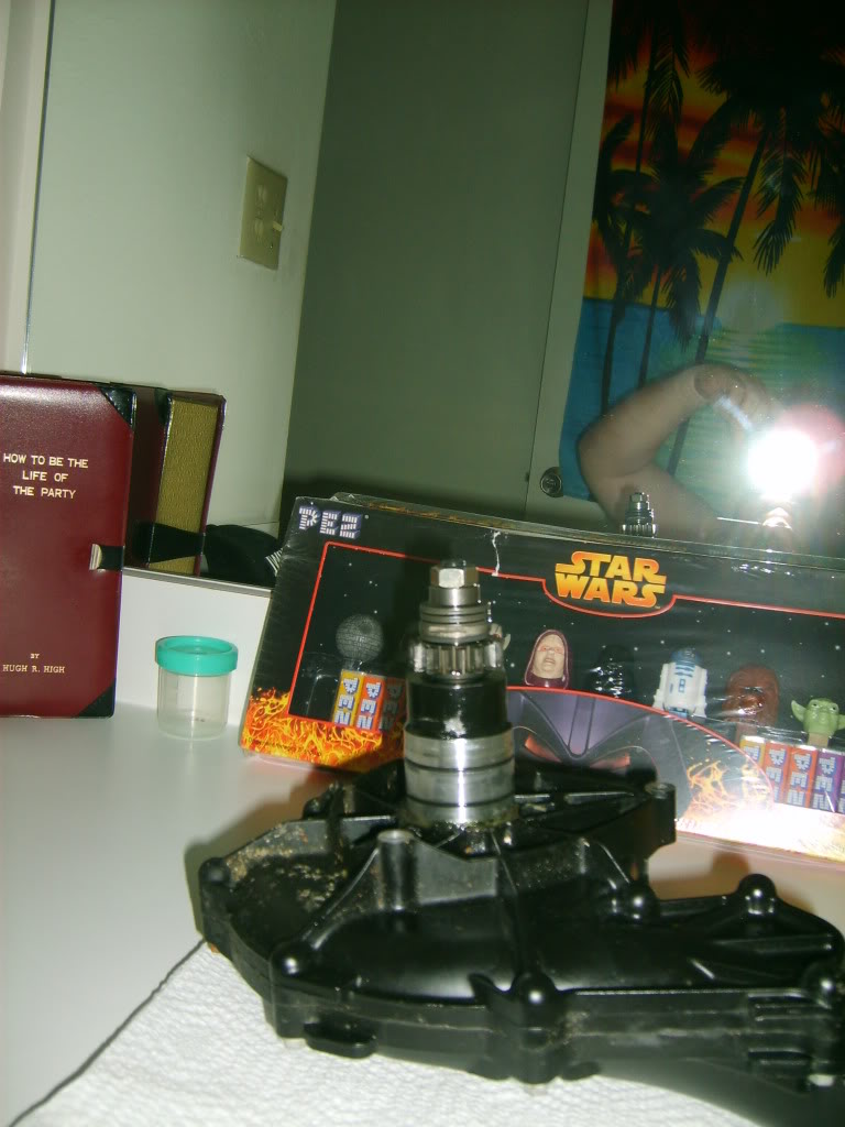

Well, she's out of the boat. Can anyone tell if the washers are ceramic or not???

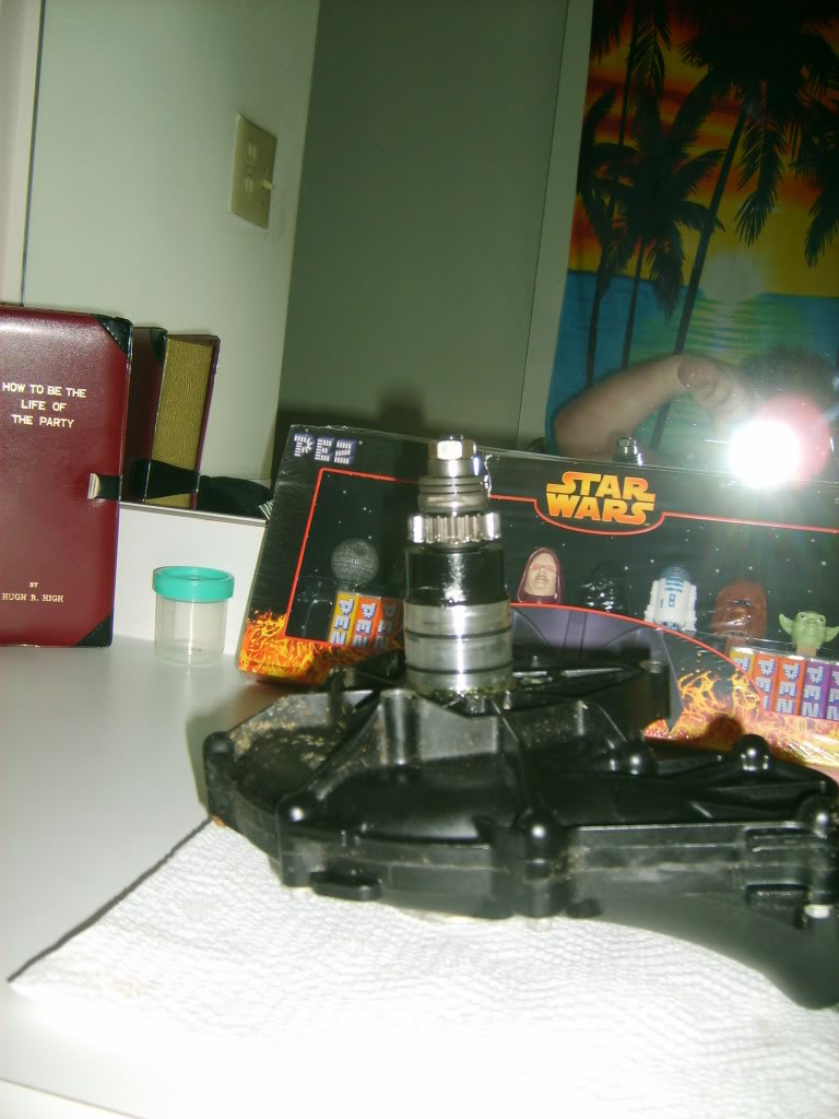

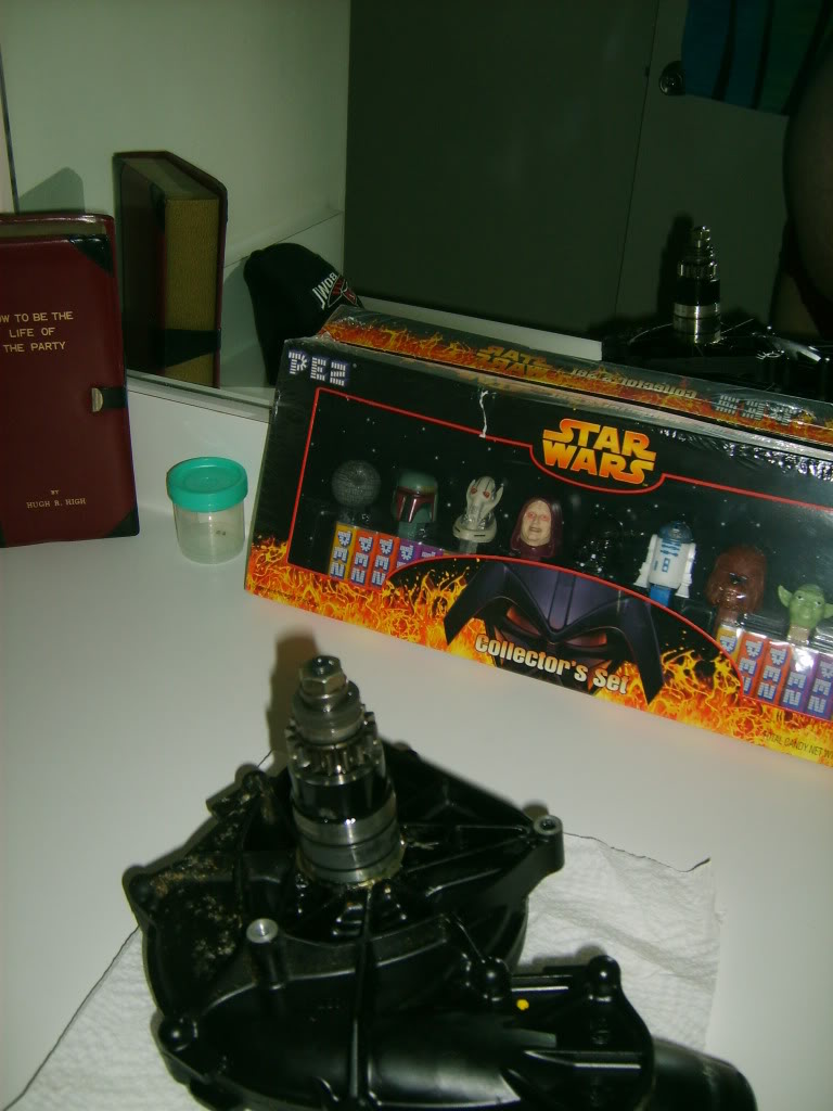

Is it supposed to spin so easily?? Plus, the gear spins on it's own?? Third, is the gear movement laterally normal??
Well, after searching all over the net and the other PWC sites, it seems I am missing the outer washer, which is why I have the play in the gear. All needle bearings seem to be accounted for, there is no damage to the gear nor the needle bearings, plus the impeller is not off center nor chewing up the housing. I wish I had a better camera, and I wish someone with repair experience would make a post in this thread (hint, hint).
So, what is my next step?? I think I'll be talking to my dealer I bought it from, and checking into returning it, or getting money back for needed repairs. I had sea trialed it, and it seemed to have been running fine. We never did WOT it, and I only ran it for like 5 minutes. We ran it to about 45 mph, but I had no idea what the boost should of felt like.

I try to help when I can, but Ive never cracked one of the SeaDoo superchargers. You may want to send Chester a PM. I think he is the only full time "pro" watercraft mechanic on the board.
Anyway... I would try to find where that washer went. if it broke, and dropped into the engine... it could mess things up.
At this point... the type of washers on SC is irrelevant. Replace them with the Riva tool steel washers. They don't shatter when they go bad, and that can save your engine.
Since one of those ceramic washers is missing, you are going to have to take the engine apart to clean out the 2 oil pumps and inspect for damage. Those ceramic pieces will damage the oil pumps if left in.

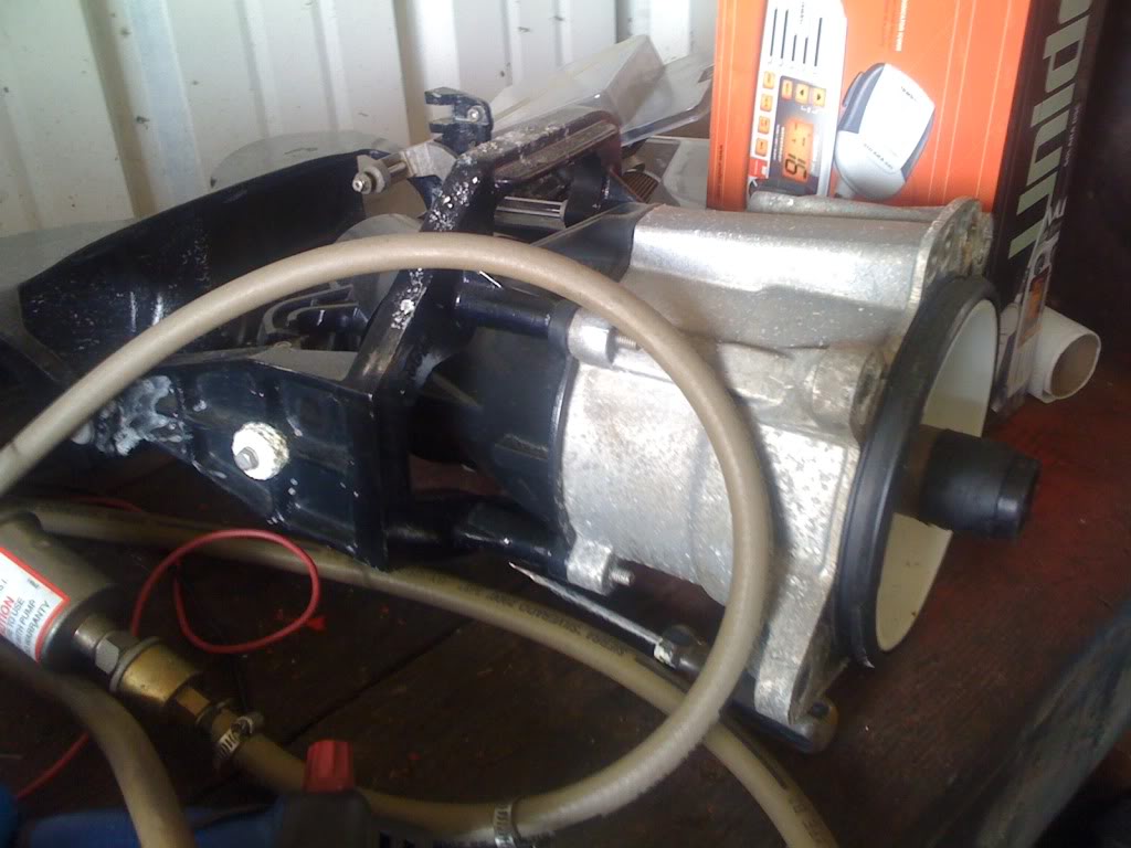

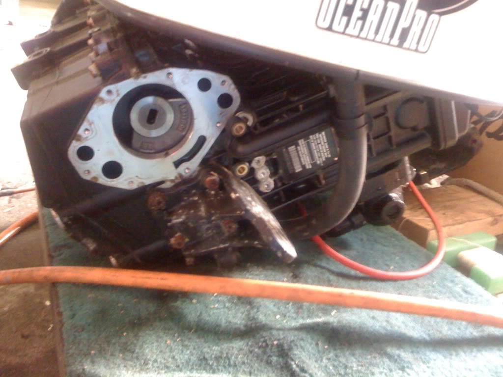

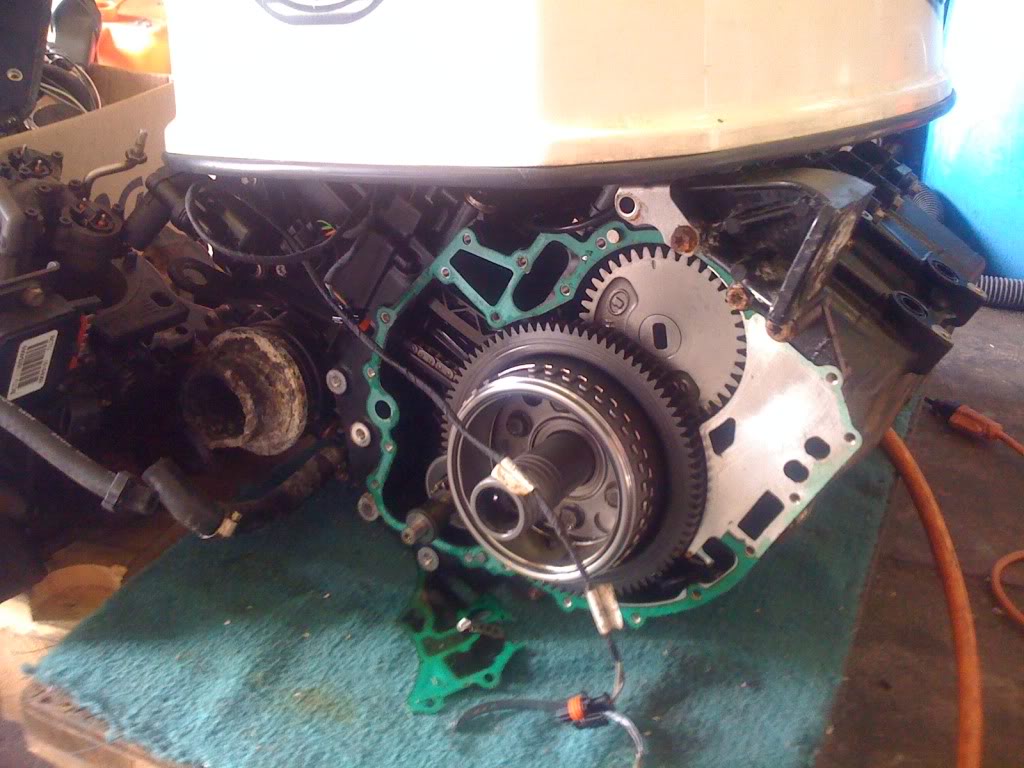

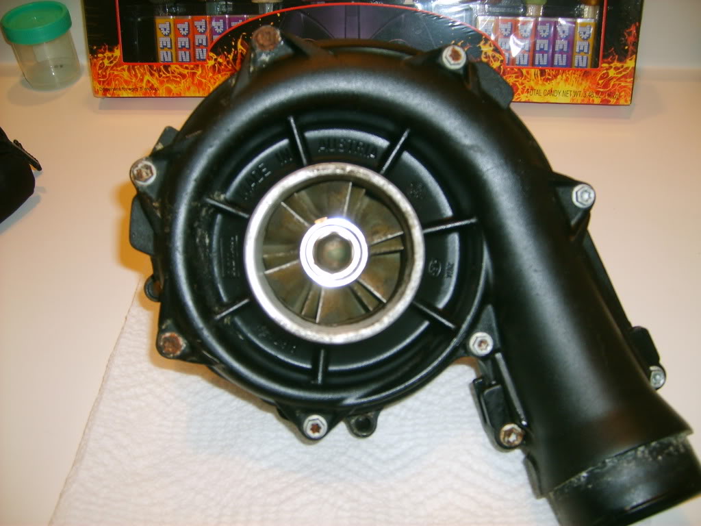

It seems they're having a hard time getting the right parts for my oil pumps. My dealer sent the pumps to a jet ski repair shop because they wouldn't tell him where to get them machined. They had originally called SBT (since it's right here), and were told they didn't have the parts available (they have a core swap program). So they sent it out to these other guys, and a 2007 oil pump got sent back for 1 of them, and it allegedly doesn't match up. The 2nd shop probably sent it to SBT, because it's the same price that SBT charges. Here's some pics of the torn apart powertrain.
My poor baby

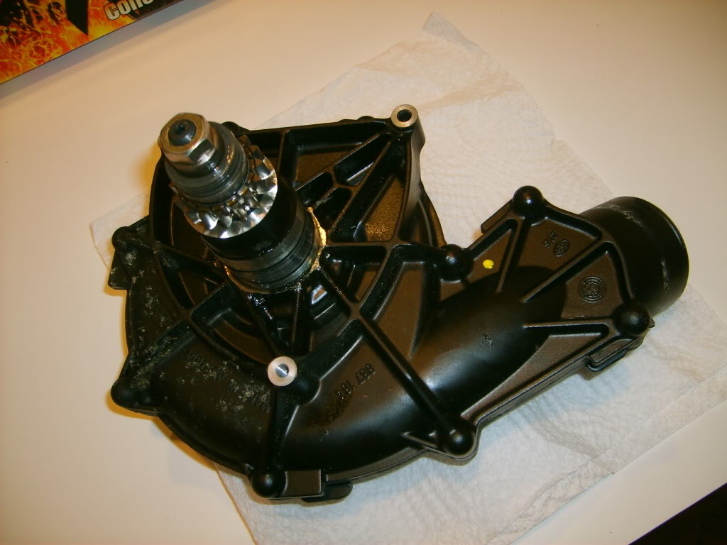

The SC is rebuilt
The Rotax looks in great shape, except for that exhaust manifold pipe end

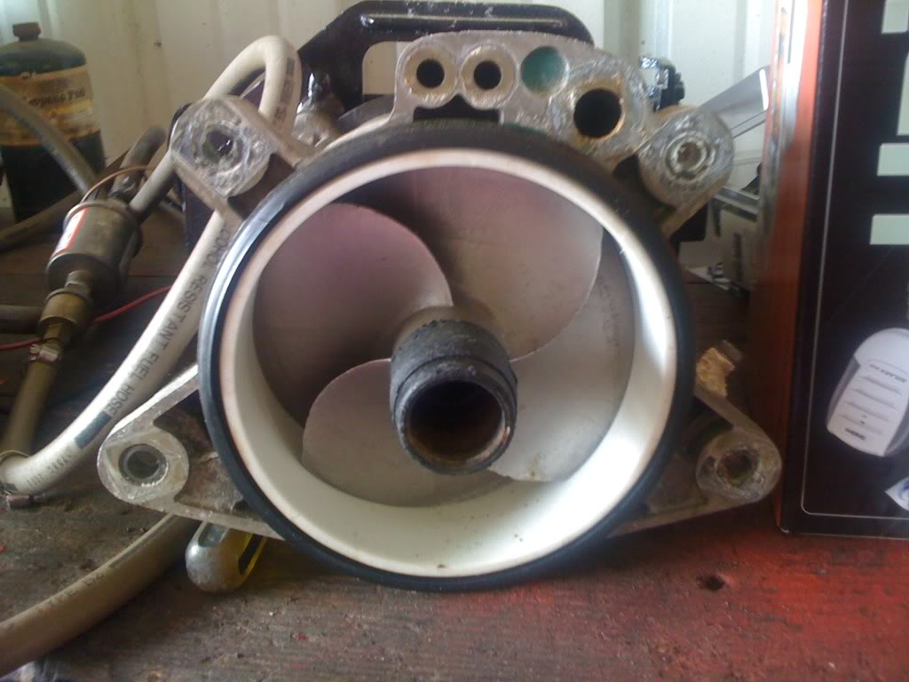

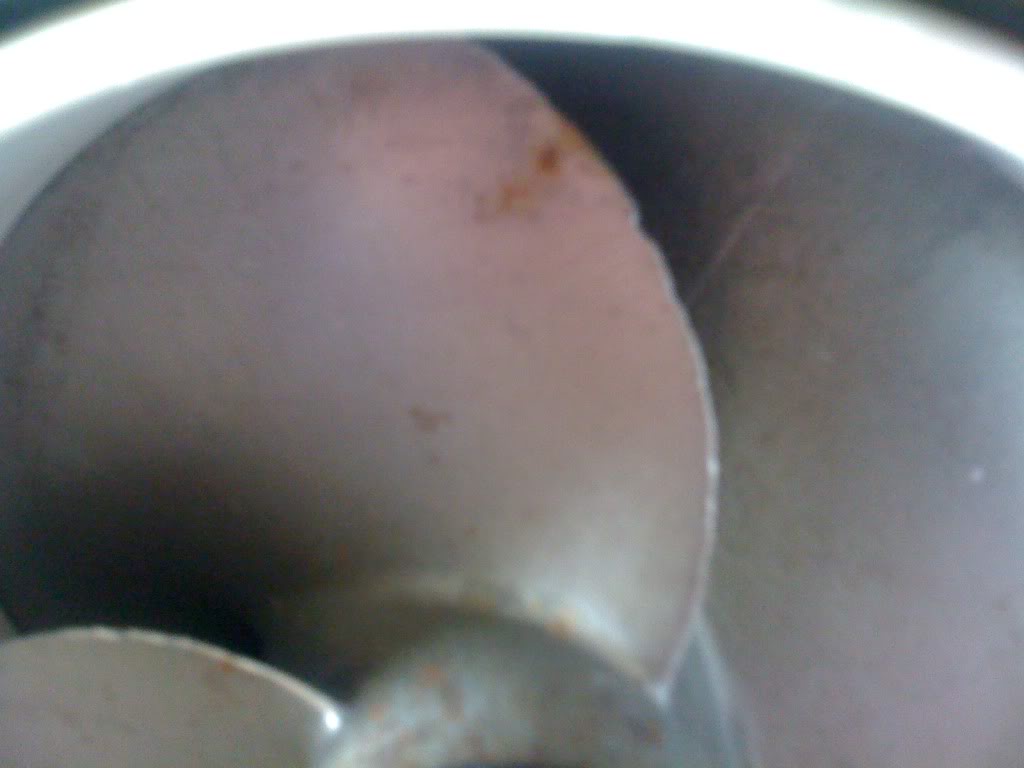

The jet pump

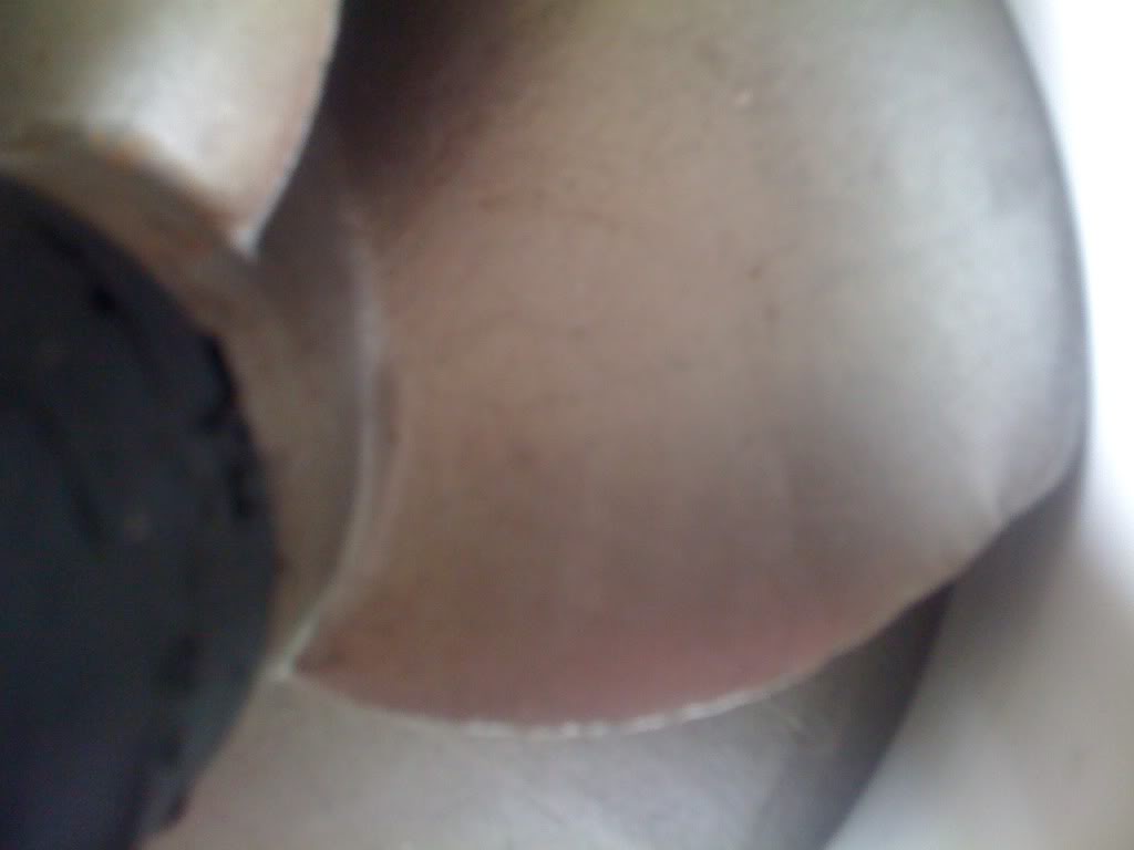

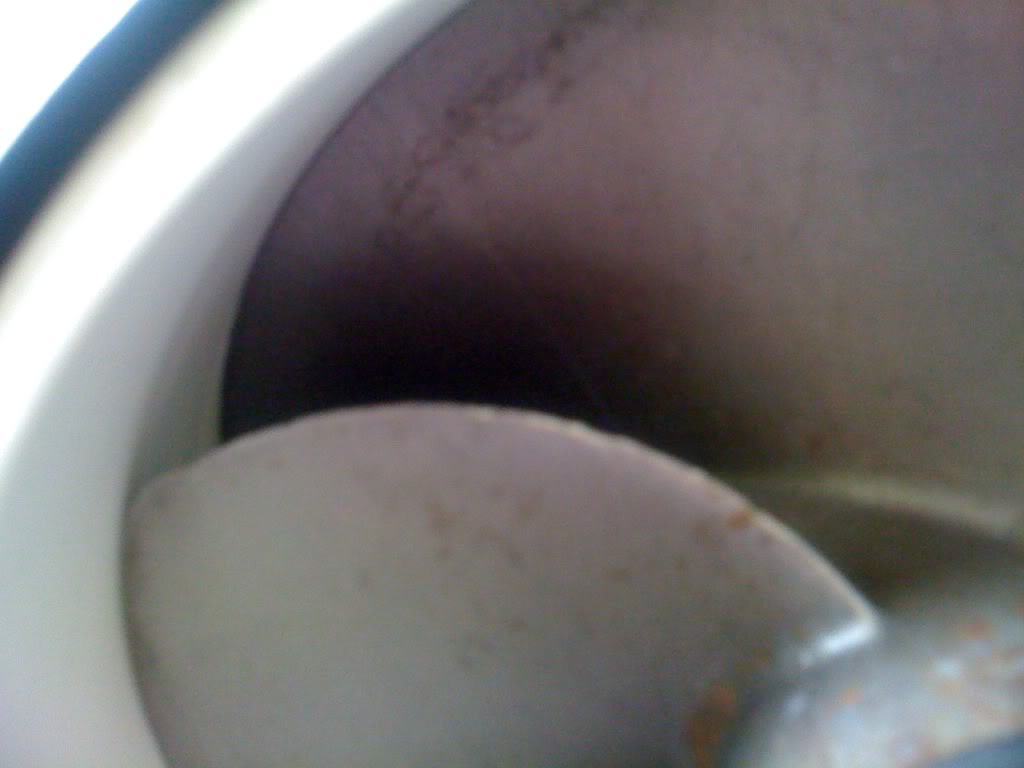

The impeller is chewed up on the inside edges of the blades, but the outer edges near the wear ring are in perfect shape. Do I need to worry about a new impeller??
