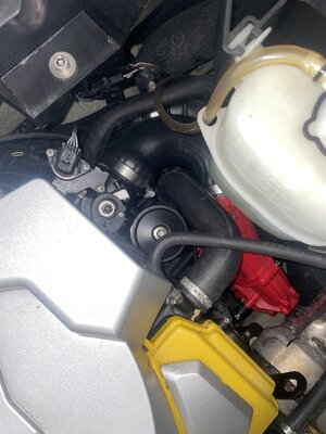

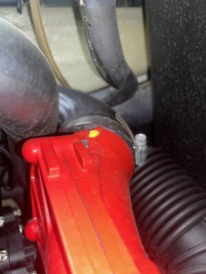

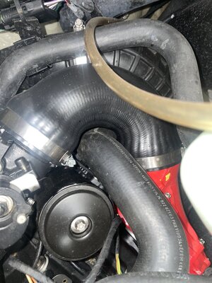

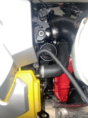

I bought a really clean 04 RXP with only 109 hours. The person I bought it from told me the supercharger was rebuilt at 80 hours. Oil looked clean and it seemed he kept up with all maintenance and was stored in his basement after being winterized every year. I was wondering if I should go ahead and have the supercharger rebuilt or take him at his word. I took it out on the water and it ran perfectly. Got a top speed of 66 with two people on it and rpm’s were all where they needed to be. Would I be okay running it the rest of the season before rebuild?

I can normally tell if the supercharger has been rebuilt by just looking at the clamp position and direction and by looking at the sealant used on the superchargers. The factory has a very consistent look and not many people other than myself will return it to exactly that look. Take some pictures of the sc and post them here. I'll give you my opinion if it has ever been rebuilt.

This would be much appreciated. I’ll get you some pictures tomorrow. Would sure feel a lot better knowing it has been rebuilt before.

Definitely has been removed and split apart so most likely it has been rebuilt. BRP did not use a worm clamp in on the output side instead it was an oetiker clamp centered right at the yellow confirmation dot with latching post towards the rear. BRP also is never that messy with the sealant because they wipe it clean to where it can just barely be seen at the joint.
I personally would still rebuild it just for peace of mind and not worth the risk since you really don't know how long ago it was rebuilt or if it was done properly.
My opinion have it done.not hard to remove I would not risk it.also check to make sure the nozzle is not bent that lubes it.back yard guys have a tendency to wiggle the charger around and move it.
