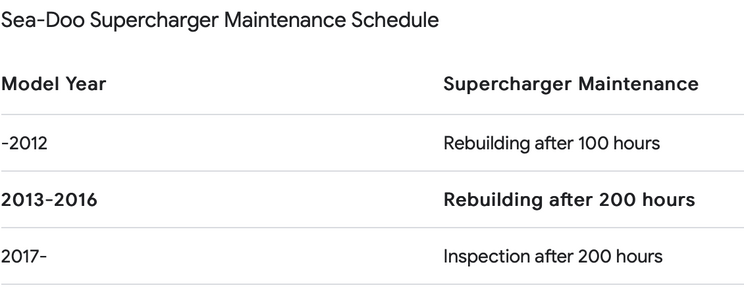

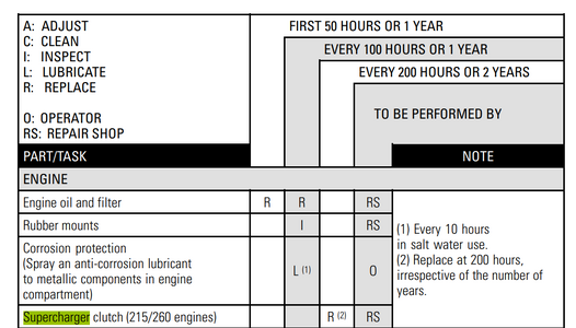

I am sure this has been beaten to death, but everyone says something different. I'm looking at picking up at 2015 Wake Pro. Everyone says the superchargers have to be rebuilt at 100 hours prior to 2017, yet the owners manual states a clutch replacement is needed at 200 hours. When did Sea doo actually switch to the metal washers and why does no one ever discuss a "clutch replacement" Thanks!
The "clutch" are the metal washers which use to be ceramic, then nickel, then steel and they are famous on this forum. The hours of use are related to the washers and the time in service the bearings, and the proper oil usage relates to both.
